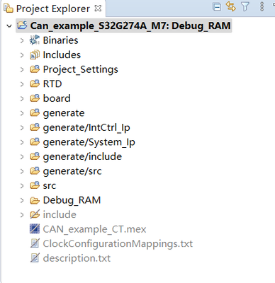

Hi , All I use s32g274ardb2 board to test the can drivers with M7 core
I use S32 Design Studio for S32 Platform 3.4 to import can example and debug the project using PE debugger in  s32g274ardb2 board , then it can run and debug it.
Now I want  to run LINUX BSP in A53 core , so  I writing the image into the SD card and set the switch setting.
But it can not uboot successfully.
I use the old and new image and dtb (Tested and uboot successfully before debug the code ), now it all reports errors.
doubt the image or SD card has problem, so I change it , it also failed. The board settings do not change.
So I doubt that it has something wrong with the previous debugging code with m7 kernel and effect the A53 boot.
Please help me to find out the problem, thank you.
