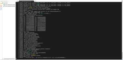

When we start both m core and a core together,  we are facing kernel panic issue in A core side and some of the features like CAN and I2C are not working in m core side.
What might be the issue
Here is the error message
I have attached the kernel log file.

This is a problem of the kernel itself don't find memory to execute, check your ddr, do a  ddr stress memory and/or build the kernel again.

When we remove llce and pfe distro feature, then it is booting properly. We feel the issue is due to resource conflicts between M and A core. Can you please let me know how to configure llce as slave so that it can boot properly.
