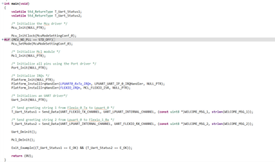

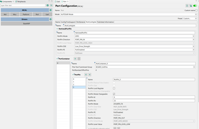

Hi everyone,
I have an evaluation board with a s32k118. I progam with S32 Design Studio and use S32K1 AUTOSAR 4.4 - R21 RTD 2.0.0 D2308 Example Projets for the uart_Eample_S32118. When I want to run the program, I get stuck on this line because the status is in error:
I don't modify the example code. This is my main :

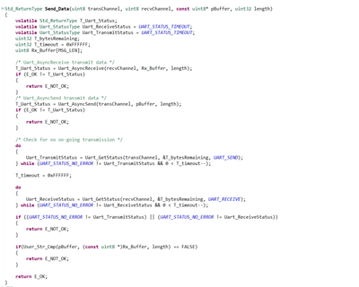

This is the function send_Data :
When I use UartSyncReceive, it's working well.
Can you please help me with this ?
PS : The Uart_AsyncSend is working well.
Thank you in advance

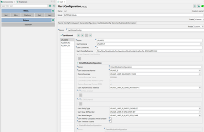

Hi @sbusc
The examples are provided to work out of the box. As your code gets stuck in Uart_GetStatus() the first time it is used, it looks like the receiver in this case UART_RX has a problem. Verify that the pins are connected correctly, Lpuart instance 0, communicates with Flexio instance 0 channel 0 for Rx, and channel 1 for Tx.
The available board schematics can be downloaded from S32K118EVB Evaluation Board – Schematics and S32K118EVB Evaluation Board - REV A Design Files
B.R.
