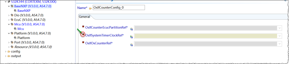

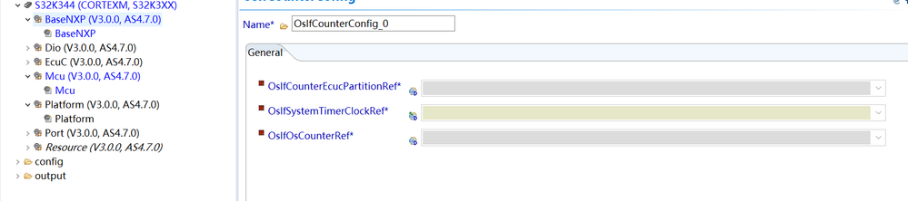

Use EB tresos 29, OsIfSystemTimerClockRef, It's not editable,The MCU clock is the default, What should I do to change this option?
1,721 Views
Robin_Shen
Click icon to enable the container. Will you be able to select OsIfSystemTimerClockRef ?
