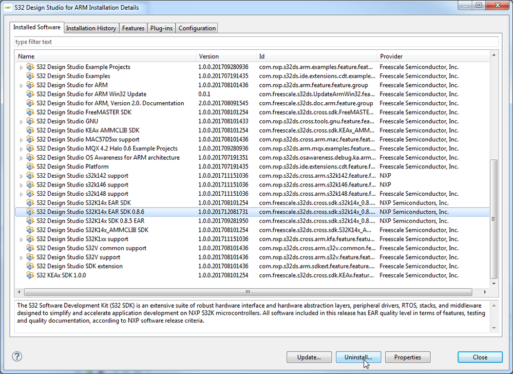

since i´ve installed the sdk version 0.86, i can´t open example projects anymore.
At first i tried the usual way "File->New->S32DS Project from Example", but nothing happens.
After that i tried "Open Projects from File Browser" and inserted the sdk 0.86 installation path. But no project opens.
With version 0.84 and 0.85 it worked.
Using:
S32 Design Studio for ARM
Version 2.0
Build id: 170810
Hoping for help
Johannes

Hi Johannes,
you can try to uninstall the update and install it again. For me is SDK v0.8.6 working okay. For uninstall click on Help -> Installation details and find SDK installation:
Hope it helps.
Jiri

Re-installing SDK didn´t work, but i think i found the problem now.
I completely re-installed Design Studio(+sdk) with the PC administrator and it seems that i didn´t have enough rights as a normal user.
After installation the admin tried to open the examples and it worked, then i tried the same with my user account but it didn´t work.
the admin changed rights for s32 folder, so it works now.
