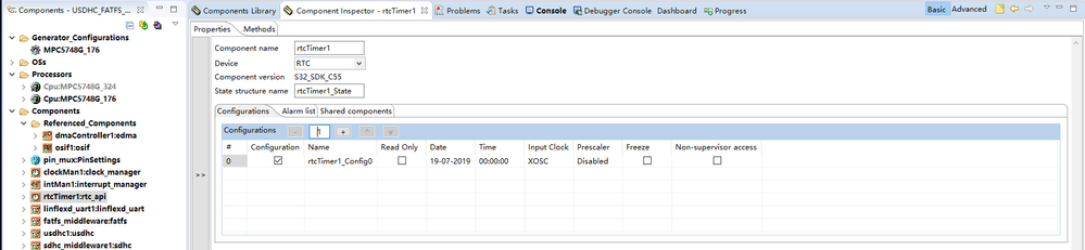

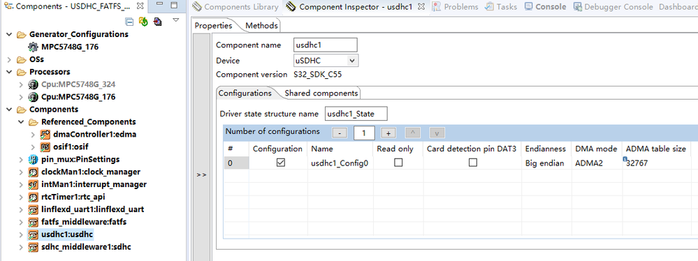

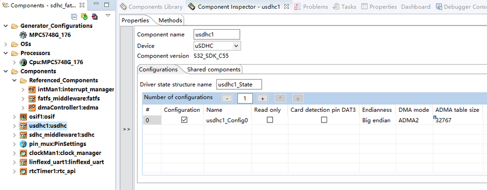

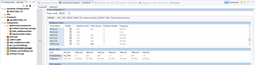

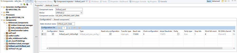

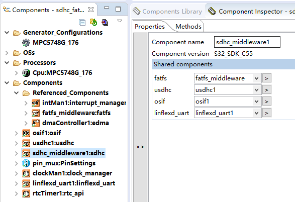

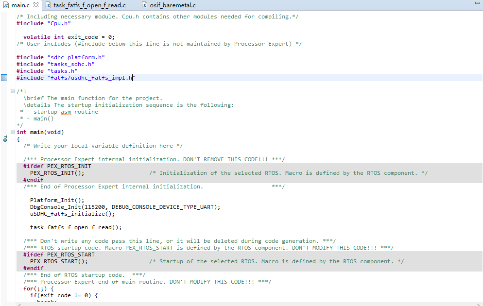

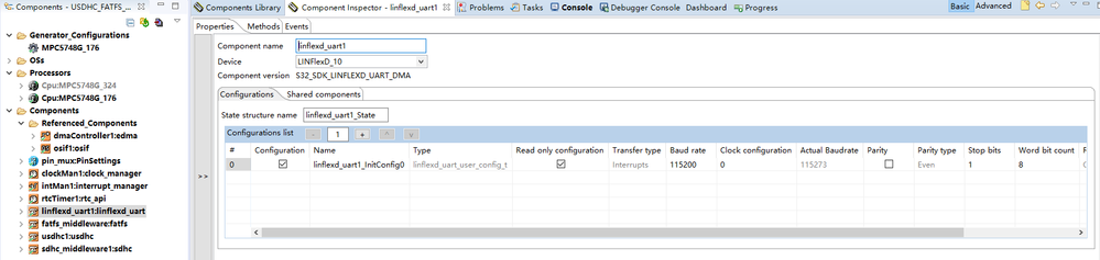

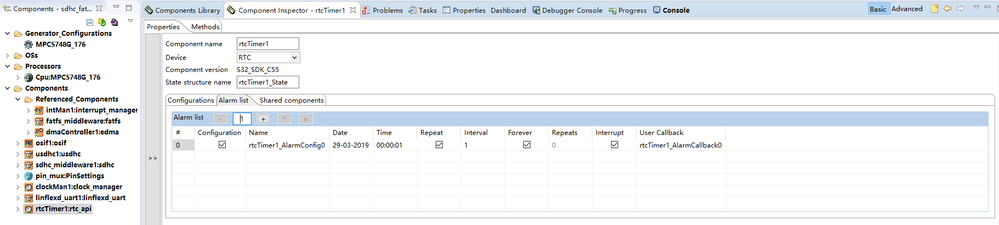

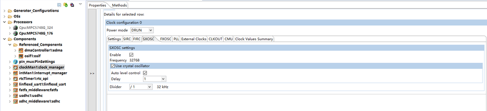

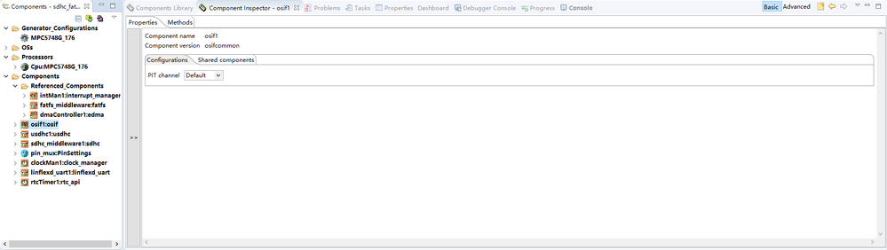

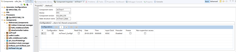

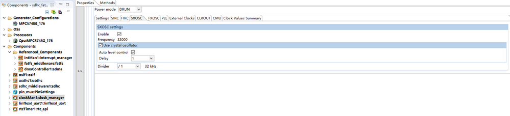

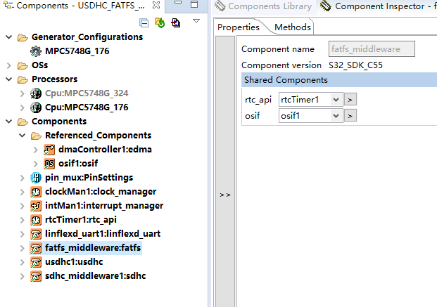

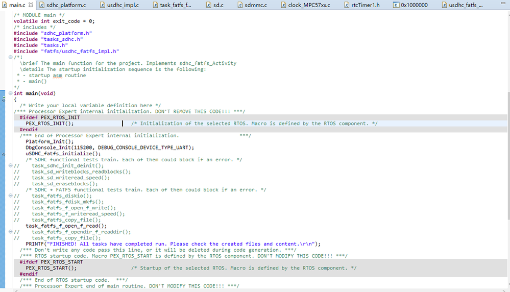

Hey Guys,
I want to read a txt file from a SD card with 5748G. First I created a project from the example project in SDK_PA_RTM_v3.0 which called 'sdhc_fatfs_mpc5748g' and it worked well. Then I created a 'S32DS Application Project' and added necessary components just like the example project. But when I debug this new project, it was stuck in fuction 'void OSIF_TimeDelay(const uint32_t delay)' and couldn't get out. So please help me to find out whether I miss some steps to make it work.
Here are some pictures to show the similarities and differences between two projects:
clock_manager of second project
clock_manager of example project
fatfs of second project
fatfs of example project
osif of second project
osif of example project
rtcTimer of second project
rtcTimer of example project
sdhc of second project
sdhc of example project
usdhc of second project
usdhc of example project
uart of second project
uart of example project
pin_mux:PinSettings
I only configured pins of LINFlexD_10 and uSDHC in the second project, but in the example project, there are more pins  configured which seems not necessary.
main.c of second project
main.c of example project

TomLightning
maybe a bit too late but I had the same issue and could solve it by reducing the cable length of the debug wires (Debugger to Microcontroller).
Hope I could help!
Tom
