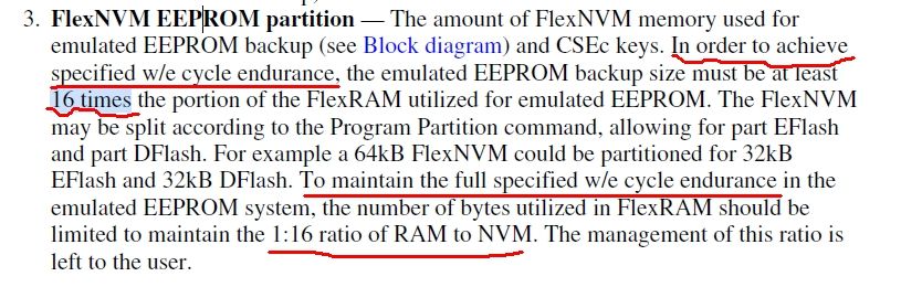

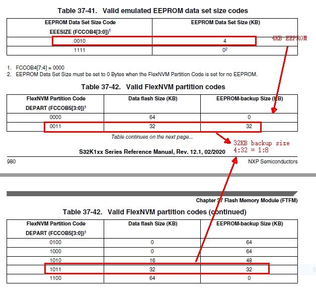

we are going to split 64KB D-Flash to two 32KB part, one 32KB for HW emulation EEPROM(4KB, set the NVM Backup size 8 times the portion of RAM), and the other 32KB for SW emulation EEPROM (implement sw driver).

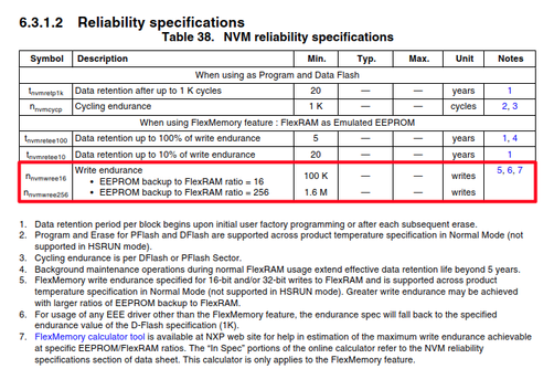

I noticed that you mentioned about the least ratio of EEPROM backup size to FlexRAM portion, which is 16 times.
so I read the S32K146 RM again, and it says for "specified w/e cycle endurance", the ratio must be at least 16, but in the Table 37-42 "Valid FlexNVM partition codes", it support "0011" and "1011" for a ratio of 1:8 (RAM:NVM).
Is this least ratio (16) a must requirement ?
if it is able to set the ratio of HW emulation EEPROM of 1:8 (RAM:NVM), how much it will affect the "specified w/e cycle endurance"  ?

Yes, it is what I talked about.
However you may download FlexMemory endurance calculator:
https://www.nxp.com/downloads/en/calculators/FME-Calculator.zip

Another point which speaks against the use of SW emulation is that native endurance when HW emulated module is higher (about 12.5x) that programming over FTFC commands (when it is used as data flash). It is given by EEE algoritm use advanced HW techniques that are not available if you use SW emulation.
