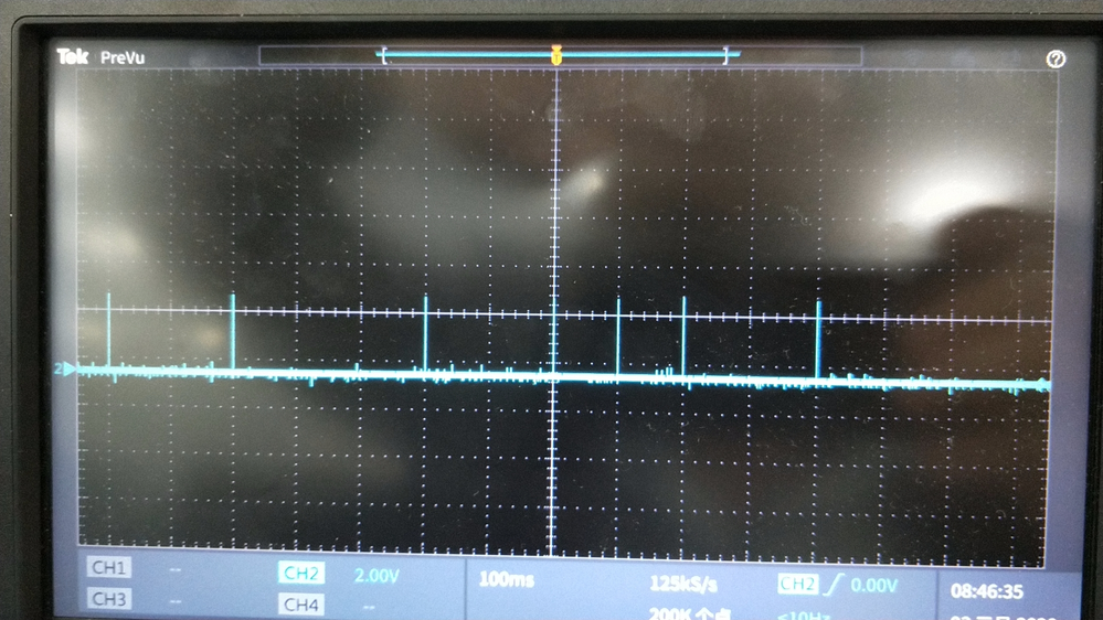

SPI_MasterTransfer(&spi3_palInstance, &data, &RxBuffer[eSPI2], 1);/*Frames are often lost when sending messages here
SPI_MasterTransferBlocking(&spi3_palInstance, &data, &RxBuffer[eSPI2], 1, 1000);/*There is a failure to send the data, and the program will jam.
  • The following picture shows the loss of frames of data sent over a period of 100ms.

I think I have known the reason for the loss of my spi sending data. In the SDK routine, the baud rate used by spi is relatively low, such as 50K;There was no problem in the test of this communication rate in my code, but when I continued to increase the communication baud rate of spi to more than 300K, spi began to lose frames of data, and the higher the baud rate, the more serious the frame loss.I tried to increase the clock on the lpspi, but it didn't work.Do you have any ideas?
4,919 次查看

In "IO Signal Table", S32K146 gpio-hd pins are relatively few, and I have already used all three lpspi. There seems to be no gpio-hd function in my three spi. I wonder if the ordinary GPIO of S32K146 can't support such a high spi communication rate (such as 1M)?Generally speaking, microcontroller spi at 1M communication rate is not high, S32K146 such a powerful microcontroller should not have this problem, if I want to use so high spi communication baud rate must modify the hardware (spi pin specified gpio-hd)?My MCU bus has been configured so high that I really can't figure out where my problem is. Can you help me?
