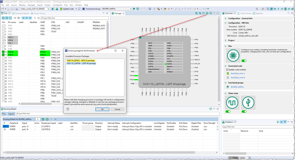

Developing with the S32K116 routines in the SDK cannot run offline mode every time after debug is over. I have checked START_FROM_FLASH, and now I suspect that the memory allocation and address of S32K116 48pin and 32pin are different (the chip I use is 32pin). Could you please give me a copy of S32K116 32pin routine with SDK, or please help me analyze where else I can go for investigation

Seems that you already refer to did not run without debugger
Please import hello_world_s32k116 example of S32K1 SDK403 in S32DS v3.4 and switch package.

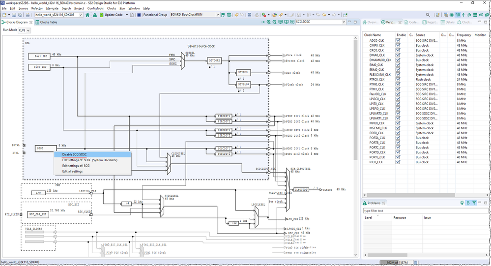

If there is no external 8MHz crystal, please disable it in Clocks tool.

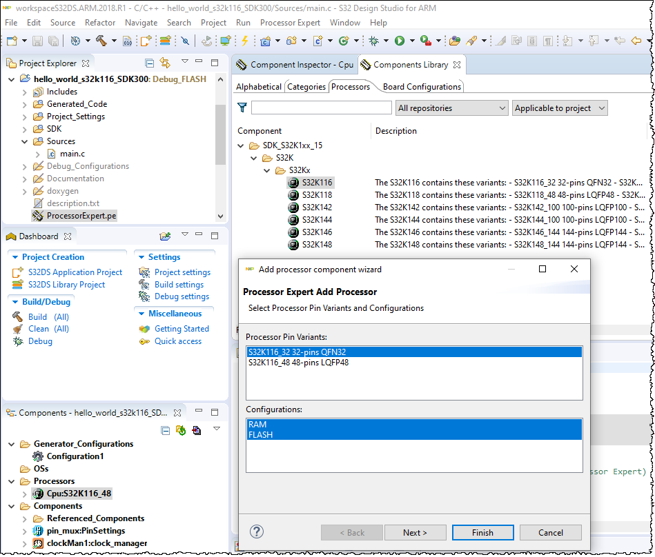

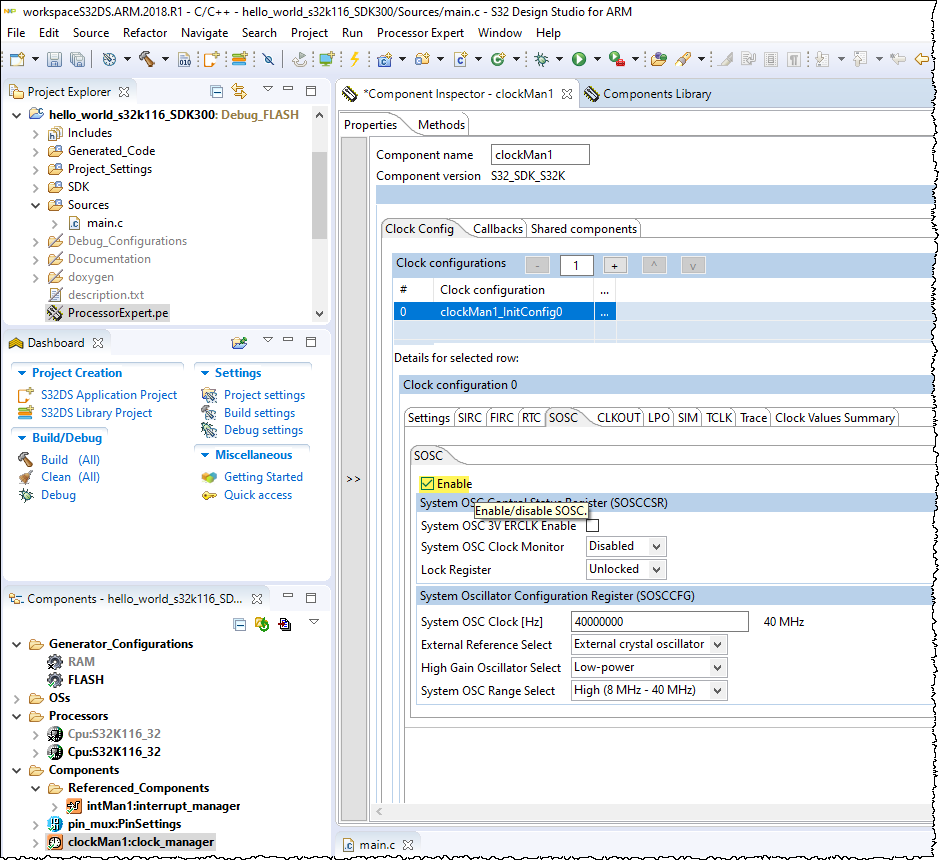

My IDE Version is S32 Design Studio for ARM Version 2018.R1, where can I find these graphical configuration interfaces, especially clock trees, that look cool
1,724 Views
Robin_Shen
S32 Configuration Tool is used to configure Clocks and Peripherals in S32DS v3.4. Processor Expert is used to configure it in S32 Design Studio for ARM Version 2018.R1.
Select Processor Pin Variants and Configurations.pngdisable SOSC Processor Expert.png

Huan89898989
Okay, I can find these configurations. Thanks for your support
