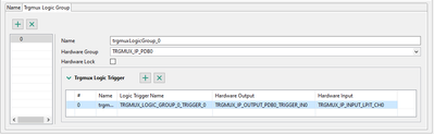

should the LPIT trigger PDB-ADC? As the example sets the PDB too and by default ADC is set to be triggered from PDB. There is check box "Enable SIM ADC source selections" in ADC component which allows you to change HW trigger to be done from TRGMUX (LPIT).
So if LPIT-PDB-ADC sync should be done then TRGMUX should be set to have
BR, Petr

I used the tips you provided to make the example work as intended. It now triggers the ADC conversion every 10ms.
I attached the sample project in case anyone wants to see a sample implementation
