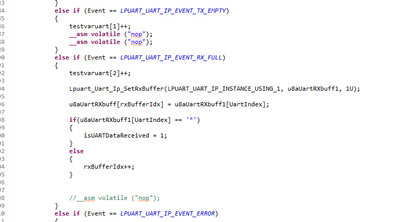

I have configured LPUART 1 interrupt mode and facing receive over run error. Below are the some details on the version and configurations
S32 Design Studio for S32 Platform
Version: 3.5
RTD: 3.0.0
Baud rate set : 9600
I'm trying to read with in the callback configured.
Please help on this issue,

Hi @Dev15,
Normally this issue is caused by priority configuration. It could be solved by increasing the system clock frequency or decreasing the BaudRate.
Are you testing the reception with the CAN echo? Could you transfer just one byte at a time to test reception? This community post solved an overrun issue by moving the SendData function into the rxCallback function: uart_pal_s32k144w status = STATUS_UART_RX_OVERRUN - NXP Community.
Since you are using RTD 3.0.0, I assume you are using S32K3. You can look into this community post as reference as well: Solved: The S32K344 Lpuart transfer cannot receive data correctly when DMA enable - NXP Community

Hi @Julián_AragónM ,
Thank you for your response.
I have tested one byte and it is working fine.
When the request is on a continuous mode, it is throwing OR error after sometime.
