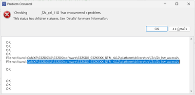

as the title
CY9_0-1759280216858.pngCY9_0-1759280216858.pngCY9_1-1759280228168.pngCY9_1-1759280228168.png
in file '.project' :
#S32DS S32DS-S32PLATFORM #RTM402  S32DS-ARM
タグ(3)

Hi @CY9,
The SDK release notes specify the compatible IDE version.
S32SDK_for_S32K1xx_RTM_4.0.2_ReleaseNotes.pdf
BR, Daniel

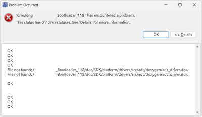

CY9
I don't think this is the root cause.
If you're right ...
(In this case, )
Why does it *ONLY* happen with `adc_driver.dox`?
Why does it *NOT* happen with `osif.dox` before it and `clock_manager.dox` after it?
This happens with different .dox files in different projects, (and it always happens with the .dox file?).

Hi @CY9,
It does not matter that the issue only occurs with the files only. In general, NXP does not guarantee the SDK functionality when used with incompatible software. Even if we resolve this particular issue, similar problems may arise later. To ensure a stable environment, please start with a fresh installation of S32DS 3.4 and install only SDK 4.0.2 — do not include any other SDKs or RTDs.

CY9
Wouldn't you recommend installing version 3.5 directly?
Also, is it not recommended to install SDK4.0.1 at the same time?
Just install 4.0.2 ONLY ?
3,026件の閲覧回数
danielmartynek
S32DS 3.4 is compatible with the SDK not 3.5.
If you want 3.5 or the newest 3.6, use it with a compatible S32K1xx RTD.
In general, yes, it is better to have just one SDK/RTD per an IDE installation.
You can have more S32DS installations.
