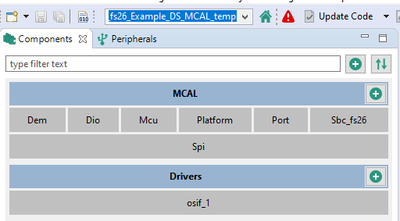

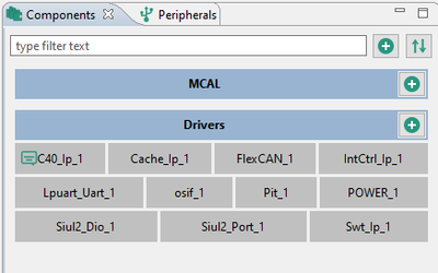

In my project I am targetting two hardware revisions from within the project. The revisions differ slightly in code, but also in pin out and peripheral configuration.
Therefore, I need to be able to have multiple pin configurations and peripheral configurations. I succeeded in doing this for pin configurations, but for peripheral configurations I am having a harder time. The unsuccesfull steps I follow are these:
1. Go to "Peripherals" view
2. Open "Functional Group Properties"
3. Add new "Functional Group". This creates a new option to select in the "Functional Groups" drop down. Both options result in the same "Drivers" being shown (see below for the same view for both groups)
4. When I remove a driver, it is removed for both Functional Groups, whereas I only want it removed for the Functional Group under change. How can I make this possible?
In the end I would like to achieve two parallel Functional Groups which both configure eMios instance 1, but with different parameters.

Hi Nam,
Thanks for getting back to us. When trying again - also with S32DS Version: 3.4 Build id: 201217 (Update 3) - it seems to work for me. I can add/duplicate a new function group, and can add/alter configurations. Even though I am not planning to use this feature anymore, I believe this is what I would want.
However, I think my initial misunderstandig of its function was that when I remove any of the elements in the left "Components" view, they will be removed from all Function Groups, not only the one currently active. However, I now realize this is more of a UI/UX misunderstanding than functional issue.
