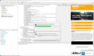

richespiritu
I've been having trouble opening the .mex file of the HVBMS bringup project. I've tried a couple of reinstalls but I always run into this error when opening the configuration file. Here is my installation details.

Robin_Shen
Seems that you forget install S32K3xx development package 3.5.2.202304051438. Please refer to the step 3 of HOWTO: offline install S32K3 RTD 3.0.0 in S32DS v3.5.

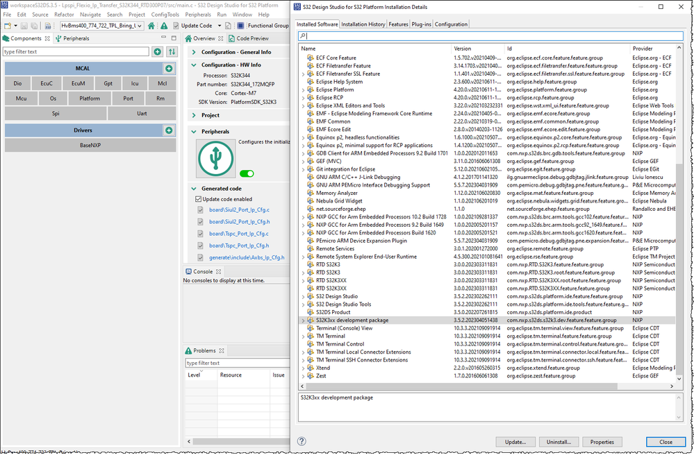

Robin_Shen
I only installed S32K3 RTD 3.0.0 completely according to "HOWTO: offline install S32K3 RTD 3.0.0 in S32DS v3.5" and did not encounter this problem.
I am able to open .mex file of HvBms400_774_722_TPL_Bring_Up even if HVBMS related software is not installed.
So I later did not install these software according to SW32K344_HVBMS-RD_Bring-up_Example_S32DS_1_0_2_ReleaseNotes.txt.
S32K3xx development package 3.5.2.202304051438.pngS32K3xx development package 3.5.2.202304051438.png

richespiritu
Hi Robin,
I uninstalled and reinstalled RTD 3.0.0 based on the instructions, and I was eventually able to open it. My problem now is that going through the tabs in the configurator tool is super slow. When opening the .mex file on startup takes 10 minutes, and s32 design studio enters a (not responsive) state.

richespiritu
I believe I already have it installed, as seen in the installation information above. i have tried opening a different project, the bring-up example for MC33775, and this is the message that I get.
4,854 Views
Robin_Shen
