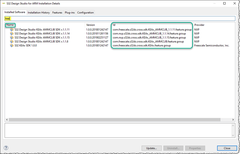

It's strange why your S32K116 project needs 'com.nxp.cross.arm.kea.feature.feature.group 0.0.0'. When did this error message pop up?
Have you tried to search "kea" in installation Details? Check if there is a correlation in the Id column
Installation Details search Id Name.pngInstallation Details search Id Name.png

lleviton
The error occurs when installing updates.
Comparing old PC logs and new laptop logs, they both have 4 SUCCESSFUL lines of:
Install File: C:\NXP\S32DS_ARM_v2018.R1\eclipse\features\com.nxp.s32ds.cross.arm.kea.feature_1.0.0.201801242127\feature.properties
Status: SUCCESSFUL
Install File: C:\NXP\S32DS_ARM_v2018.R1\eclipse\features\com.nxp.s32ds.cross.arm.kea.feature_1.0.0.201801242127\feature.xml
Status: SUCCESSFUL
Install File: C:\NXP\S32DS_ARM_v2018.R1\eclipse\features\com.nxp.s32ds.cross.arm.kea.feature_1.0.0.201801242127\license.html
Status: SUCCESSFUL
Install File: C:\NXP\S32DS_ARM_v2018.R1\eclipse\features\com.nxp.s32ds.cross.arm.kea.feature_1.0.0.201801242127\META-INF\MANIFEST.MF
Status: SUCCESSFUL
Why does the error say it can't find
com.nxp.cross.arm.kea.feature_0.0.0
and not
com.nxp.s32ds.cross.arm.kea.feature_0.0.0  ???????

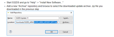

lleviton
During off-line updates, I have been leaving "Add Repository Name" blank.
Could that be the problem?
What does "Local" do (see image below).
Also, on my old PC, I installed all of the updates in sequential order, starting from Update 2.
On my new laptop, I installed Update 11 first.
It seems there are things missing in Update 11.
Should I install Update 10 first?
Or does the order of installing updates not matter?

lleviton
Problem resolved.
S32 Design Studio for ARM 2018.R1 - Update 11 does not install the S32K116 SDK.
Update 9 must be installed first.
Update 10 must be installed second.
Update 11 must be done last.
Include (check mark) all items except Pemicro and Segger drivers because they will stop installation due to a defect in their jar files.
Updating in the reverse order does not work and is very time consuming because it must check whether it is overwriting a newer release.

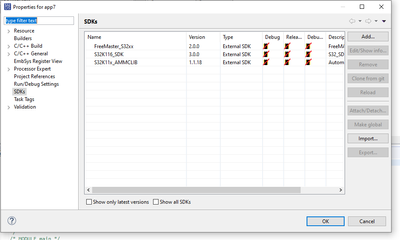

mikedoidge
Hi Larry,
First of all, when you launch the S32 Design Studio for Arm v2.2, make sure to use a new workspace. There are often elements of Eclipse which have been upgraded in the newer tool and the workspaces are specific to the Eclipse version. You can copy over your project, it is independent of Eclipse version.
When you bring a project from an older tool to the new tool, the SDK which was attached to it remains. If you wish to migrate the project to a new SDK, for the versions we are discussing here, I think it should be possible. The main thing is the ProcessorExpert settings. If you right click on the project name in the Project Explorer window and select 'Export', then select the 'Export Component Settings' from within the S32 Design Studio for Arm v2018.R1, you should be able to import these into the project in S32 Design Studio for Arm v2.2.
After you import the v2018.R1 project into v2.2, you probably will need to detach the old SDK and attach the new one. Then you can import the settings and re-generate the code. There may be some manual adjustments needed if function call name changed, etc. I'm sorry, but the SDK team isn't as great about backward compatibility as we might like.

lleviton
Hi Mike,
I'd rather not put any more time into this, but you make a good point.
This product is going to be around for a long time, so maybe migrating to a newer version of Design Studio will save my company a lot of grief later on.
Would it be better to migrate to S32 v3.4 instead of ARM v2.2?
Can Processor Expert v3.4 import from v2018r1?
If not, using Processor Expert is still a time saver, even without importing.
I spent a couple of hours yesterday using v2.2, only I imported ProcessorExpert.pe instead of exporting it.
I had to manually add on include path to get v2.2 to build without errors.
