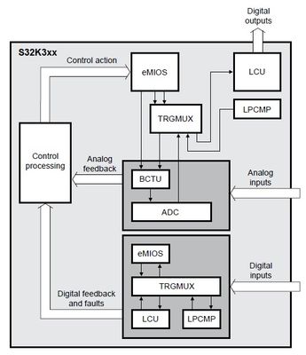

kyf
Contributor V
Hello @MVR .
Yes, but prefer to use BCTU instead of a direct trigger to ADC conversion with TRGMUX. Because the BCTU peripheral has many many usefull functions for your needs.
Read chapter 57 of the reference manual and you can see how every "part" is connected in order to set-up a system that will make use of the peripherals.
At the moment I'm trying to configure :
1. OPWMCB with leading edge flag
2. next this flag will be sent to BCTU peripheral
3. BCTU will trigger the ADC conversion according the the list that I've created
4. when ADC conversion is finished BCTU will inform the DMA that data are ready for transfer
5. DMA will transfer data to the desired buffer
Check the block diagram from chapter 57:
