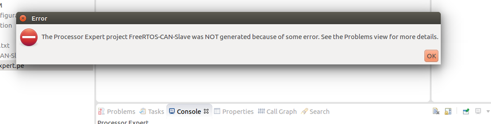

I am porting the FreeRTOS -FlexCAN for mpc5748g board And I am using the S32ds v1.2 Power PC along with latest update EAR 0.8.0 and 0.8.1, for processor Expert generator.
While I run Processor Expert Generate, I am getting the below error
And my console out put is showing the errors for flexcan
ERROR: Unexpected status of script: Beans\flexcan\Items\S32_SDK_C55\flexcan.chg, please contact Freescale
ERROR: Unexpected status of script: Drivers\Common\EBGNSupport\TimingLib.prg, please contact Freescale support.
Generator: ERROR: There are errors in the project, please review components configuration. It is not possible to generate
Can you please help me how to resolve this ?

unfortunately, Processor Expert is not supported under Linux operating system. Please check the thread below:
https://community.nxp.com/thread/460747
