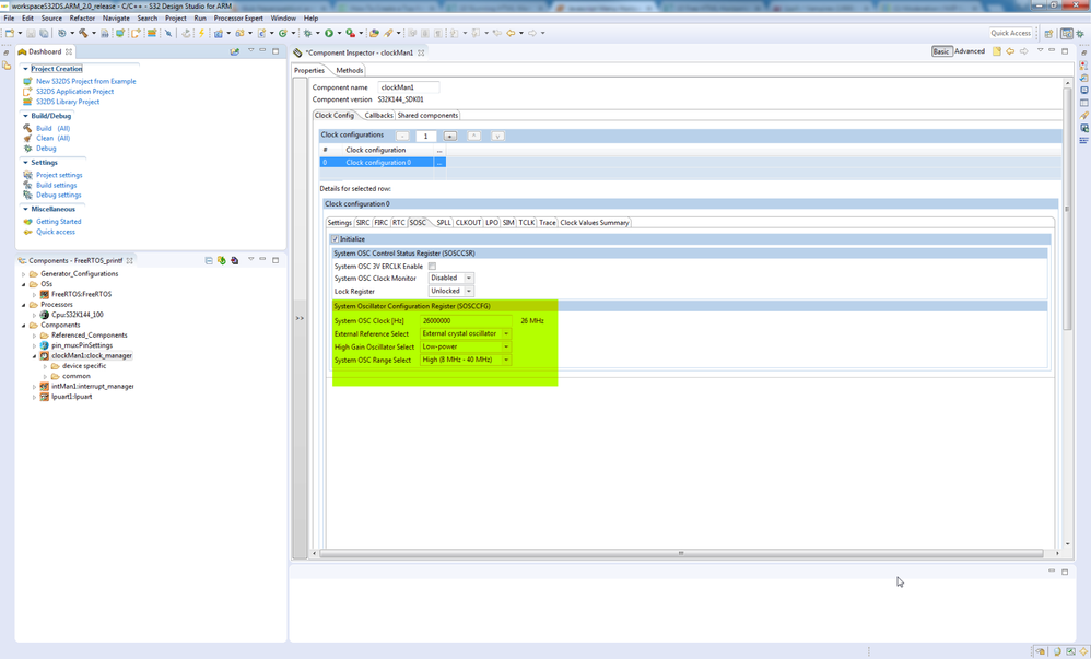

Most of the projects created in S32 Design studio is having 8Mhz oscillator value.
How can I change it to 26 Mhz ?
Please guide.

jiri_kral
Hi Mohan,
you can set external crystal frequency value in the Clock manger. You also need to tune clock dividers/multipliers to have resulting frequencies for peripherals in correct range (see warnings in the Processor expert).
With 26 MHz crystal you may have hard time (combining dividers/multipliers) to get maximum performance for example for core clock (max is 112 MHz). Better idea is use crystal frequency which can be divided by 8. From my point of view - usage of 8 MHz crystal is okay. Do you have some special reason for using 26 MHz crystal oscillator?

mrajanna
Contributor V
Hi Jiri,
This requirement is not for S32K144 EVB.
This requirement is for one of our customized device that has miniature form of S32K144 MCU. This device is running with 26Mhz. So I want to flash UART application on this device and test it.
