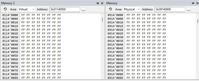

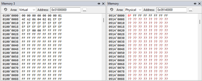

When I attempt to do the same operation for mapping flash, I do the following:
       Overlay(0x09140000, 0x01000000, 0xFFFF0007, 0);
Correct me if I am wrong, but I am under the impression by "default" 0x09000000 mirrors 0x01000000, but manipulating the overlay functionality in the PFLASH module allows a user to create a virtual address so to speak to point to a different region - such as I did successfully with the RAM overlay.
The issue I am seeing is the following:
After I call the "Overlay" routine, I get this:
I do not understand why 0x09140000 is not mirroring 0x01000000...  It looks like "junk" data in the memory window for 0x09140000.
2,760 Views
davidtosenovjan
MPC5744P device does not support flash over flash overlay (as it is on MPC5748G). Only flash remapping by SRAM is working with MPC5744P device.
