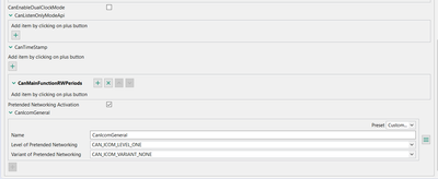

  • Activated Pretended Networking:
I enabled the pretended networking option in the CAN general settings as shown in the figure below.

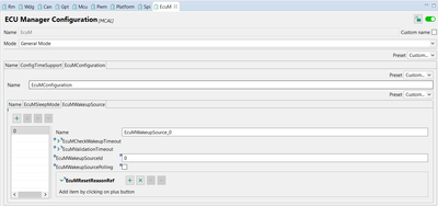

  • Configured ECUM Driver for Wakeup Source:
I set up the ECUM driver to recognize the wakeup source.

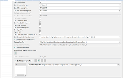

  • Selected Wakeup Source in FlexCAN0:
In the CAN configuration set, under canController, I selected the wakeup source for FlexCAN0.
  • Configured CAN ICOM to Filter by ID:
I set up the CAN ICOM to filter messages by ID.

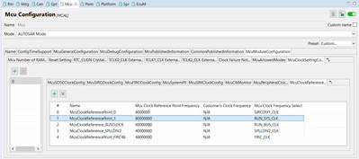

I configured the CAN settings and selected the appropriate clock sources, as shown in the figures below.

The problem is that the microcontroller does not wake up when I send CAN messages. However, if my debugger is connected, it wakes up correctly. I tried unchecking the "CAN clock from bus CTRL[CLK_SRC]" option, but it didn’t make any difference.
