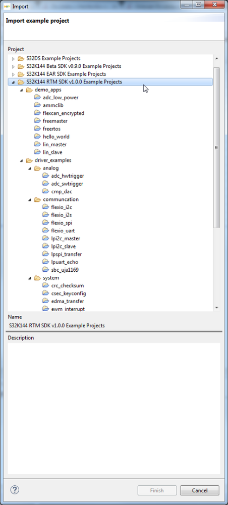

Project is created from S32K144 EAR SDK Example Projects. But there is no communication with UART. The same code is working with Interrupts. I have changed lpuart_user_config_t lpuart1_InitConfig0. (.transferType = LPUART_USING_DMA,)
Am I missing any configuration?

to be able use  eDMA  data transfer mode - you also need init eDMA driver by adding this line in the main function:
EDMA_DRV_Init(&dmaController1_State, &dmaController1_InitConfig0);
front of UART init.
Another suggestion from SDK team is to use latest RTM SDK version. Lot of bugs is fixed there.
Jiri

axb
Thanks. It worked. Could you let me know how do I update my current SDK?
6,665 Views
jiri_kral
If you have installed all updates (main menu bar -> Help -> Check for updates) - you can create project from example with latest SDK version
Jiri
