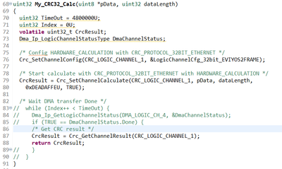

RickYeh777
Thank you for your quick response and accurate judgment.
Originally, this project’s LPUART + DMA was working normally. After I added the CRC32 + DMA code, it started failing.
Now, if I remove the CRC32 + DMA code, the LPUART + DMA still works correctly.
However, I cannot figure out how the CRC32 + DMA code affects the operation of LPUART + DMA.
It is really not easy to find the key configuration inside S32 Config Tools.

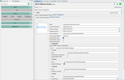

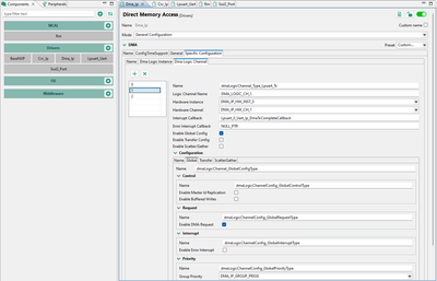

Below I have attached the CRC32 + DMA configuration, hoping it may reveal the potential issue.
标记 (1)
350 次查看
RickYeh777
Hi, Julián
If I add the CRC32 + DMA code but comment out Dma_Ip_GetLogicChannelStatus(), the LPUART + DMA also works correctly.

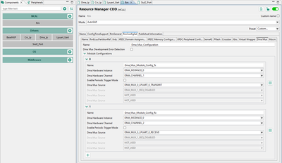

Julián_AragónM
Hi @RickYeh777
Sorry for the late reply. There really should be no issue —unless the same Dma channel is used for Crc and Uart communication.
I've imported the Crc example, and added Uart module with Dma transmission, and everything seems to be working:
Please confirm if pin assignation is correct, Dma channel configuration matches the Uart MUX, and if same channel is not used for Tx/Rx:
Julián
