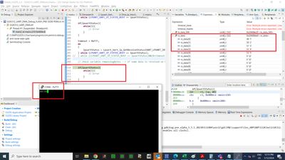

 The purpose of this demo application is to present a usage of the
 UART IP Driver for the S32K3xx MCU.
 The example uses LPUART6 for transmit & receive five bytes using the DMA.
* Test HW: S32K3X2EVB-Q172
* MCU: S32K312
* Compiler: S32DS3.5
* SDK release: RTD 3.0.0
* Debugger: PE micro
* Target: internal_FLASH

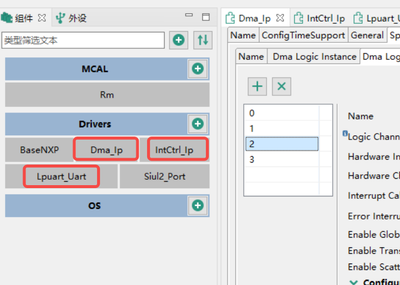

Hello, it is difficult for me to configure other channels by referring to the additional code project. Can you help me configure the sample project of the UART2 channel and upload the configuration picture? thank you.
li3
I configured the new project UART6 through the configuration item of the attached project example, but it failed. Is the configuration missing?
