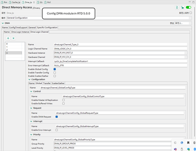

1. I config DMA module in S32DS IDE, but some files, such as Dma_Ip_Types.h is not generated and some file content doesn't match my setting.(See below figure)

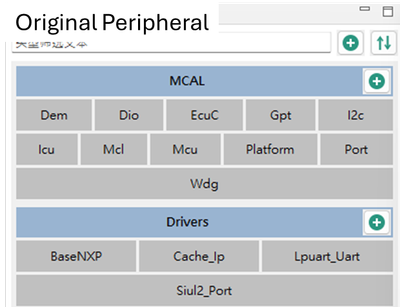

Step0: Here's my original Peripheral config.(Only timer, interrupt, port, i2c and UART for debugging). This part works fine before switching to DMA mode. I didn't change I2C Asynchronous Method to USING_DMA just to verify my config has no other issue.

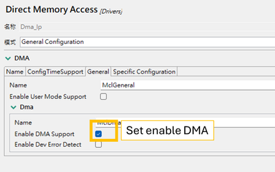

Step2: Setup DMA module by enable DMA support

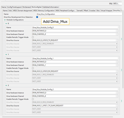

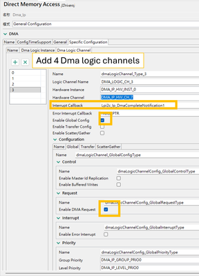

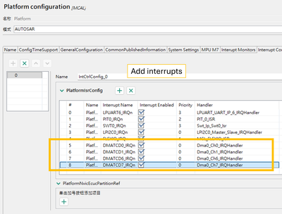

Step3: Add 4 DMA logic channels(as this article, using HW CH0, 1 and CH 6, 7)
Step4: Add IRQ to platform module

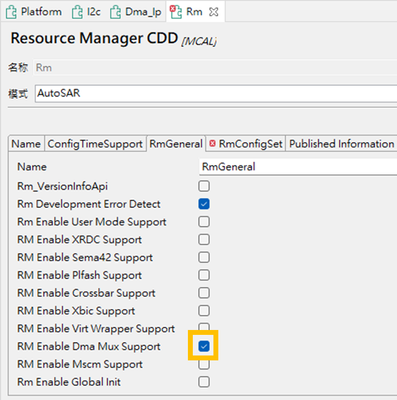

Step5: Enable dma mux in RM module(resource manager CDD)
Step6: Add 4  Dma_Mux_Module_Config(as RTD 3.0.0 example code)

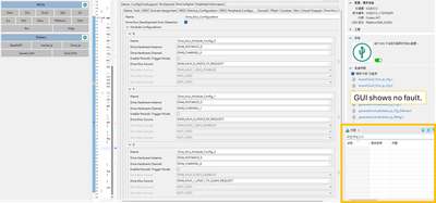

Step7: GUI shows no error in Step1~6

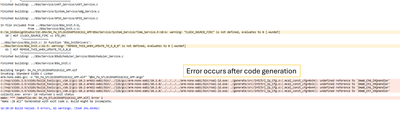

Step8: Code generation and code compile. Sadly error orruces

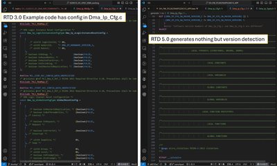

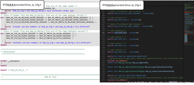

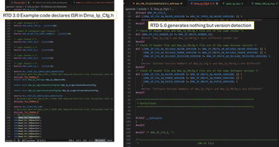

Here's the side-by-side comparison between the generated code of RTD 3.0 and 5.0
In Dma_Ip_Cfg.h
In Dma_Ip_Cfg.c

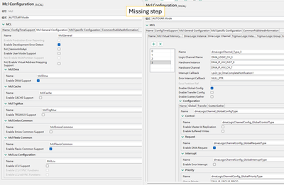

Allow me to correct myself.
I forgot to setup the Mcl module, missing config shows up after proper configuration.
Missing Step: Enable DMA support and config dma logic channel in Mcl module.

  • You have included both the Dma_Ip and Mcl drivers. Please note that the DMA configurations are already encapsulated within the Mcl driver, so the Dma_Ip driver can be removed to avoid redundancy. The same applies to Siul2_Port and Port. Only the Port driver is necessary.

  • You have enabled the LPI2C0_IRQn, but since I2C instance 0 is configured to use DMA, this interrupt is not required. Only the interrupts corresponding to the assigned DMA channels should be enabled.
