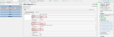

I set the LPSPI_0 as below photo show:

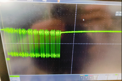

and I use the scope to test the SOUT waveform as below show:

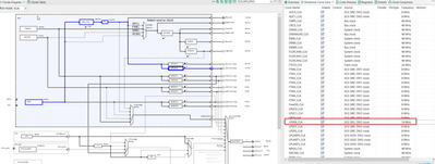

I send 20 bytes data, so I can calculate the baudrate is about 4.2M(what I set is 4.8M), and I check the clock is right. as below show:
what cause this problem? what I need is 4.8M , 4.75 to 4.85 is acceptable. but 4.2M is bad.
the second problem is I change the transfer type from DMA to interrupt. the configure as below:
and I also use the scope to test the SOUT waveform as below show:
as you can see it separate my 20bytes data to five part, 4 bytes per part. What cause this problem?

The baudrate is calculated by the RTD driver from the LPSPI clock.
RM, 51.3.1.12 Clock Configuration Register (CCR).
Can you try using a higher freq. LPSPI clock?
It is expected to see some overhead when the interrupt mode is used, the LPSPI module has 4-word TX FIFO.

now I use the higher freq(56MHZ) as below show:
but the performance did not looks better than before, it still separate to five parts(4bytes per part):
the blue is using interrupt, the green is using DMA.
are there any solution to solve this issue when I use the interrupt mode??

Hello @linton,
This is simply a limitation of the driver.
In general, the SDK drivers are big and cause some CPU overhead.
Enabling the cache could somewhat help but not much.

so to avoid this issue, I should not use the SDK interface, directly control the TDR??
2,946件の閲覧回数
danielmartynek
Yes, that would be much more effective.
If the TX FIFO is written before the LPSPI module shifts the last word, there will be no gap between the frames.
