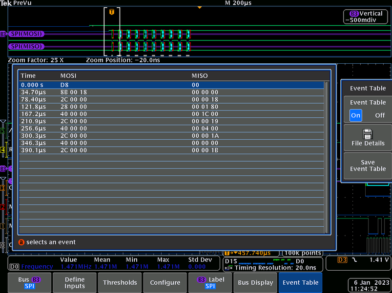

I had LPSPI working fantastically, then I went and refactored my code.  It  is now broken, and I am unable to figure out what happened.
The code is pretty simple.
Some clues -

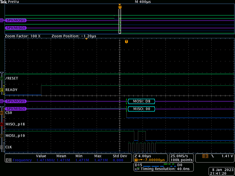

1) If I try to send one byte, it sends 7, then clock is stuck high and PCS0 is stuck low:
2) If I try to send three bytes, it only sends one.  Clock again stuck high and PCS0 is stuck low:
I did manage to get a screenshot when it did work:
Grateful for any troubleshooting ideas!

Hi@m_mishrikey
The clock line of the first picture is terminated for some reason,and I don't see any problem with the code.
Maybe add some delay before sending, and try to increase the timeout value of sending.

Regarding transferByteCount, I am able to successfully change the byte count from message to message.  So for example in the screenshot I sent, the first message is a single byte, D8, and subsequent ones are triplets.  This seems to work very well.

Delay didn't help. I also tried changing the timeout to something much longer, and even OSIF_WAIT_FOREVER. No luck.
Something really bizarre.  Is the clock line termination an indication of a problem on the SPI Master (S32K148)?  Or could the slave be misbehaving?  According to the slave datasheet the clock is an input only with 50k pull-down.
