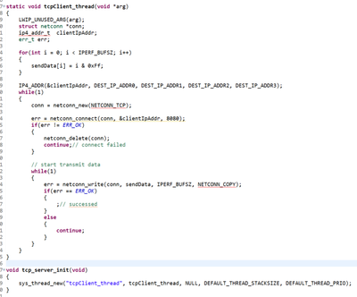

I use the example program LWIP_S32R45, which is configured as tcpecho and can be sent and received normally through NETCONN API. However, I only modify the code in tcpecho.c file When other configurations remain unchanged, EVB is used as the client and PC as the server. The netconn_connect() function keeps failing to connect and returns -13. Can you tell me why?

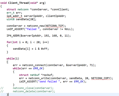

The original sample code works fine, but the original sample code is server-side code, and my requirements are client-side applications. My code uses EVB as a client based on the original configuration, simply by calling netconn_new() and netconn_connect() of the netconn API and adding the output function netconn_write() as validation. However, I can't seem to receive the ACK frame through wireshark tool. I am sure there is no problem with the server.
At present, I guess the reason may be that some configurations of the sample code need to be modified to solve the problem. I hope you can get help and reply from the application team as soon as possible.
