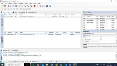

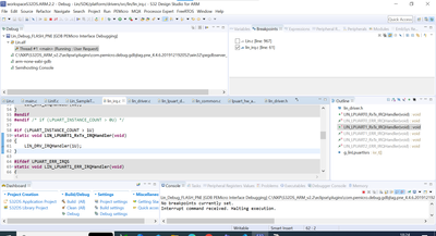

I'm testing the LIN driver with LIN interface layer the Tx header TX response is updating ,for Tx header Rx response the register level LIN_LPUART1_RxTx_IRQHandler()  the rx data was not updating .
Note: At the driver level the Tx and RX working fine.
