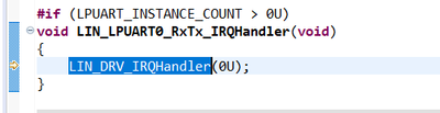

I have integrated the LIN stack from NXP SDK for S32k118 which uses the LPUART.
For my application there are many functional safety requirements and critical area where I need to disable interrupts which is leading to loss of frames in the LIN communication.
I was able to poll for the timout_service function to avoid using any interruption.
But not sure how to handle the LPUART interrupt.
Do you have any example code where the LIN stack is implemented using a polling mechanism instead of LPUART Interruption.

there is no such example. LIN stack is using SDK LIN driver and its functions are coded to be interrupt-driven.
