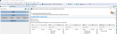

LIN middleware stack is available on when selecting SDK S32SDK_S32K1XX_RTM_4.0.1 & tool chain version GCC 6.3.
LIN middleware stack is missing on PLATFORMSDK_S32K1_2022_02_S32K144_M4F_1.0.1 () & tool chain version GCC 9.2
How to add LIN stack and LDF file for SDK SW32K1_RTD_4_4_1_0_1_D2202.

for SDK SW32K1_RTD_4_4_1_0_1_D2202 you would need select right LIN stack version
after succesful intallation you shoul dsee stack added in RTD folder
and on example created in RTD 1.0.1 you will have option to add this stack in Middleware section
Or you can create new example from a demo one
BR, Petr

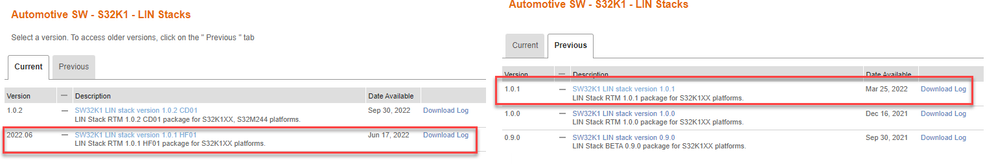

you need to download stack from S32K1 referenced SW and add it to the S32DS;
https://www.nxp.com/webapp/swlicensing/sso/downloadSoftware.sp?catid=SW32K1-REFSW-D

I have installed the LINSTACK S32K1 1.0.2, but driver is not available on components list.
BR, Petr

SivaB
Hello BR, Petr,
Thanks for your support, now middleware LIN components available on SDK SW32K1_RTD_4_4_1_0_1_D2202
