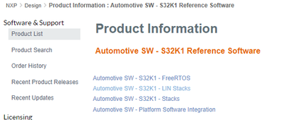

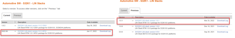

9,230 Views
PetrS
you need to download stack from S32K1 referenced SW and add it to the S32DS;
https://www.nxp.com/webapp/swlicensing/sso/downloadSoftware.sp?catid=SW32K1-REFSW-D
BR, Petr

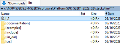

SivaB
I have installed the LINSTACK S32K1 1.0.2, but driver is not available on components list.

PetrS
for SDK SW32K1_RTD_4_4_1_0_1_D2202 you would need select right LIN stack version
after succesful intallation you shoul dsee stack added in RTD folder
and on example created in RTD 1.0.1 you will have option to add this stack in Middleware section
Or you can create new example from a demo one
BR, Petr
9,208 Views
SivaB
Hello BR, Petr,
Thanks for your support, now middleware LIN components available on SDK SW32K1_RTD_4_4_1_0_1_D2202
