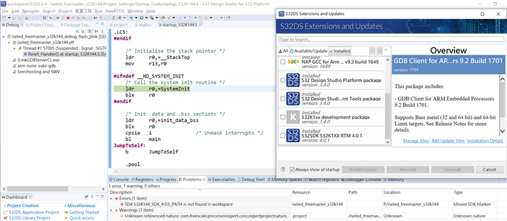

Dear
I use S32K144 ULVLL and S32 Platform v3.4 for ISELED Development, but it can't burn and execute normally, stuck in reset all the time.
I have updated to the latest and still have problems.

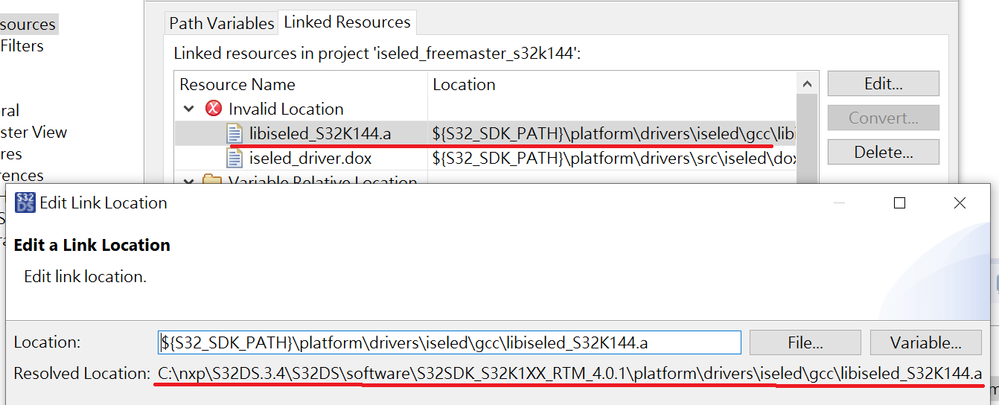

I tried to check the Linked resources and found that the SDK library "libiseled_S32K144.a" is incorrectly configured.
But the actual installation directory is C:\nxp\S32DS.3.4\S32DS\software\S32SDK_S32K1XX_RTM_4.0.1\platform\drivers\src\iseled\gcc

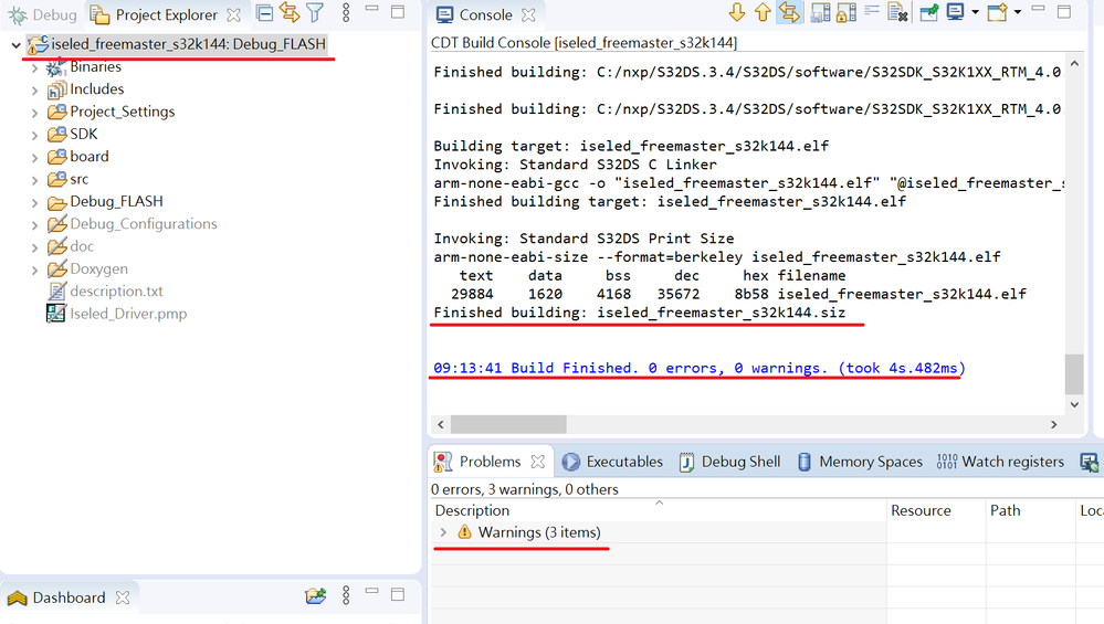

When the SDK example is loaded for the first time and Build it, there will be no problems.

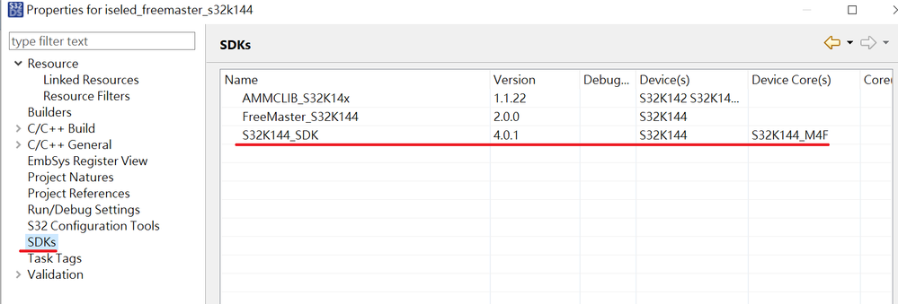

And there is no problem with the SDK configuration in Properties.

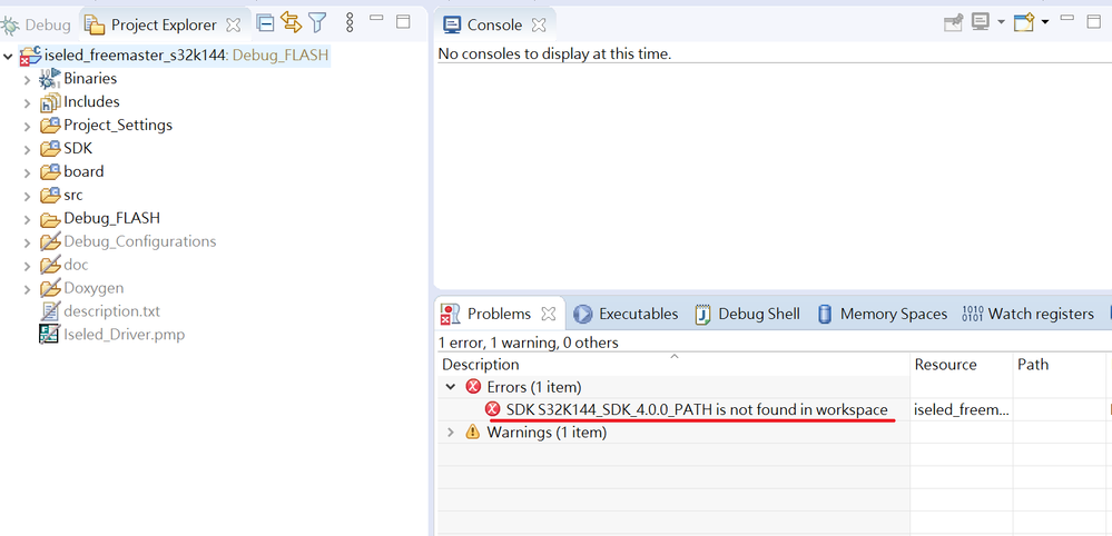

But when I close S32 Platform v3.4 and reopen it, there will be SDK S32K144_SDK_4.0.0_PATH is not found in workspace error
When opening Properties, SDK 4.0.0 error will always appear, but there is no SDK 4.0.0 configuration at all.
After pressing Yes, the error still exists and the program cannot be executed normally.
There is another problem. I use ftm_period_interrupt_s32K144 cannot be executed normally, but ftm_period_interrupt_s32K144W can be executed normally.
Please help confirm the above two questions

The failure is caused by install wrong SDK.
It is necessary to install SDK RTM 4.0.0, download site below.
https://www.nxp.com/design/software/development-software/s32-sdk/s32-software-development-kit-for-s3...
You should be able to config iseled in S32DS3.4 after installed S32K1XX_SDK_4.0.0 and S32K1_ISELED_EAR_4.8.0.exe.
