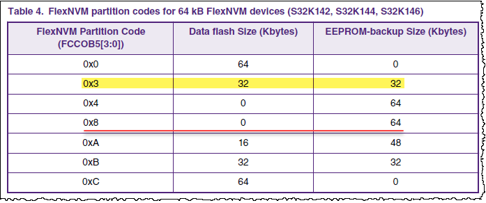

I am using S32K146.
I want to use 4Kb EEPROM and 64Kb NVM partition in my project, i tried running code example flash_partitioning_s32k146, which helped me use EEPROM partition.
But i am unable to Write or erase in NVM, The D_Flash size is 0 [ data flash 0 kb emulated eeprom backup 64kb ]as per the flex nvm partition, so the operation is failed.
How to configure the flex nvm partition ?

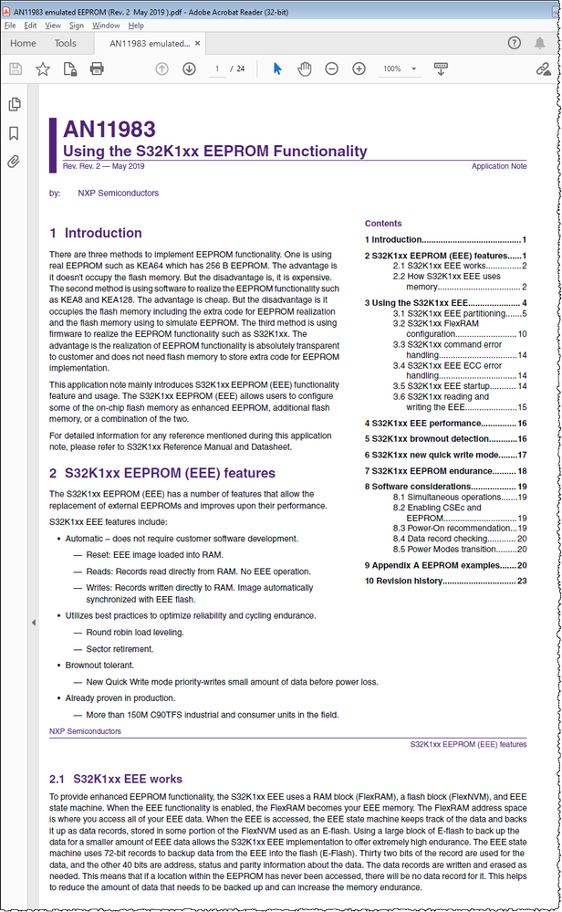

When using the EEPROM of S32K1xx, user does not need to write to the EPROM backup address. It is recommended that you read AN11983 Using the S32K1xx EEPROM Functionality

i am unable to understand here concept of backup EEPROM, i did read the said application note, but failed to grasp if i am using partition setting as 32KB EEPROM and 32kb NVM (DFlash), what actually happens to 32KB EEPROM, as i am going to use bootloader 16KB of NVM is going to be used as Bootloader, so i am left with 16KB of DFlash, but what happens to 32KB backup EEPROM ?
7,345件の閲覧回数
Robin_Shen
The training video  Benefit from FlexNVM Flash Block Memory in S32K MCUs introduces Emulated EEPROM from 10:08
Hope it helps.

Robin_Shen

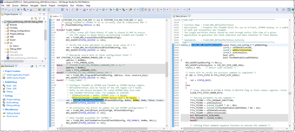

That example configure FlexNVM for maximum E-Flash size 64K
 * - EEEDataSizeCode = 0x02u: EEPROM size = 4 Kbytes
* - DEPartitionCode = 0x08u: EEPROM backup size = 64 Kbytes */
ret = FLASH_DRV_DEFlashPartition(&flashSSDConfig, 0x02u, 0x08u, 0x0u, false, true);
flash_partitioning_s32k146.pngTable 4. FlexNVM partition codes for 64 kB FlexNVM devices (S32K142, S32K144, S32K146).png

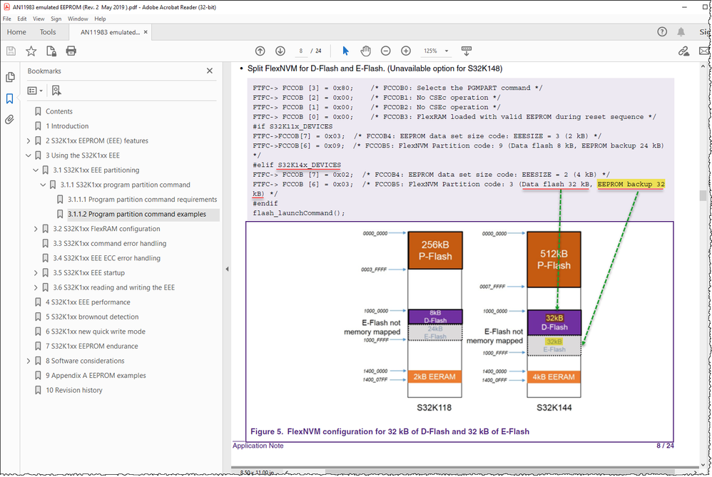

You can Split FlexNVM for D-Flash(32Kbytes) and E-Flash(32Kbytes):
ret = FLASH_DRV_DEFlashPartition(&flashSSDConfig, 0x02u, 0x03u, 0x0u, false, true);
Split FlexNVM for D-Flash and E-Flash.pngBest Regards,

s32k146_ige
Hey Robin thanks for reply,
So going by current configuration, my MCU is configured for 64Kb + 4Kb of EERPOM ? is that right ?
Also how do i access the 64Kb of EEPROM ? as i have checked i can write on 4Kb of EEPROM only
        /* Configure FlexRAM as EEPROM and FlexNVM as EEPROM backup region,
         * DEFlashPartition will be failed if the IFR region isn't blank.
         * Refer to the device document for valid EEPROM Data Size Code
         * and FlexNVM Partition Code. For example on S32K146:
        DEV_ASSERT(STATUS_SUCCESS == ret);

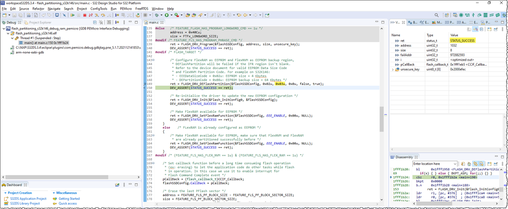

As per mentioned by You, i also tried doing following changes
but this function return Error (0x1) and code is stuck in assert condition. i have attached screenshot of flashSSDConfig variable data.
7,498件の閲覧回数
Robin_Shen

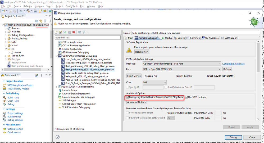

That example configure all 64 kB FlexNVM as EEPROM backup. But you want to configure 32 kB FlexNVM as Data Flash and 32kB as EEPROM backup? so:

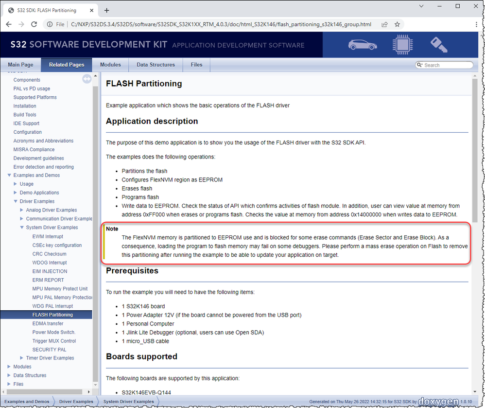

Please notice the NOTE of that example:
FLASH Partitioning S32K146 RTM 4.0.3.pngflash_partitioning_s32k146 Debug_RAM.pngflash_partitioning_s32k146 Debug.png
