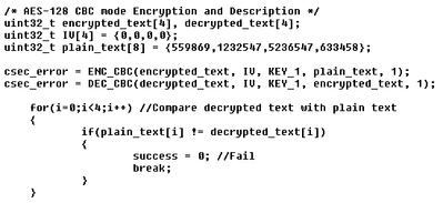

    Thank you very much for your information.I want to use AES-128 CMAC algorithm, but there seems to be no clear explanation in the demo. Is there a clear procedure for using AES-128 CMAC algorithm? I am a little confused about the use of AES-128 CMAC, AES-128 ECB and AES-128 CBC.
10,546 Views
lukaszadrapa
I think that the project 3_Basic_operations from AN5401 is quite clear:
Encryption and decryption:
 CMAC generation and verification:
Lukas

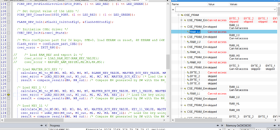

ZEROOO
    I ported the 1_Configure_part_and_Load_keys example with the 2_Update_user_keys example and added the flash driver initializer and the Csec driver initializer, but the csec_error value was always 0, indicating an error. At the same time, the CSE_PRAM register has not been accessible. Could you please tell me how to set the initial configuration of the CSEC module and how to solve the above problems.
    Best Wishes!

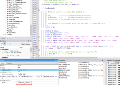

    Csec_flash_part_s32k118 was compiled in S32DS to generate ELF and SREC files.Using IC5000 burn, click the run button procedures have not been able to run normally, back onto the csec_keyconfig_s32k118 initFlashForCsecOperation functions, The reset occurs when the discoverer runs to the FLASH_DRV_EraseAllBlock function.
    I would like to ask what should be configured and what should be paid attention to to enable normal debugging of csec_flash_part_s32k118 project. Why the reset occurs when this function is executed? Is it because the program is written debug in flash but not in RAM
    Another problem is that in my debugging process of csec_keyconfig_s32k118 project, the value of keyloaded is always 0, and I cannot enter if. Later, I directly changed the value of keyloaded through ic5000 to enter if condition, but the execution of ecb encryption failed. Is it because my previous flash configuration failed to run, leading to partition configuration failure, and finally load key failure and encryption failure.
