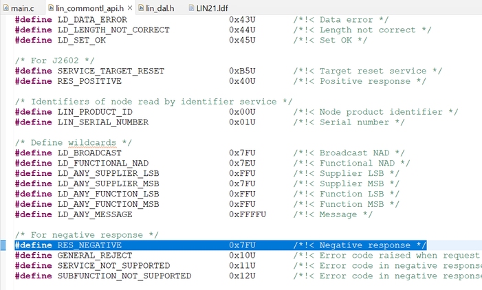

    Does the LIN 2.1 protocol stack provided by S32DS offer an interface for sending pending messages? If not, how can it be achieved? Are there any demos available?I want to ensure that in the diagnostic service, if 0x78 is sent, the unfinished diagnostic service can be continued to be executed.

The Stack supports RES_NEGATIVE but not 0x78 NRC_RESPONSE_PENDING.
