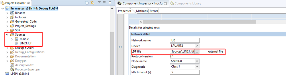

Issue: Unable to upload the .ldf file.
Could you please help on above issue. When i'm browsing for the file too, unable to find the ldf file.

Hello Vidyasagar,
At first, I would like to recommend you to look at the S32DS lin_master example. The LDF file is located in the Sources folder. You can modify according to your needs.
For example, see the image below:
I hope it helps.
