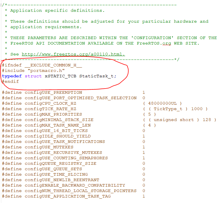

The example compiles and runs fine, however I would like to use static memory allocation, therefore I change this setting in the Processor Expert:

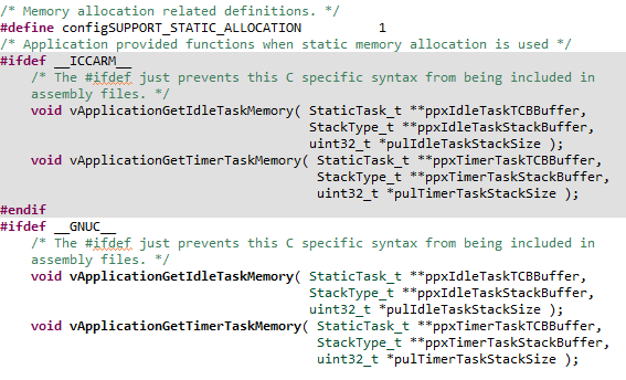

This way a few new lines are added to the generated FreeRTOSConfig.h:
When I try to compile the code, the following error occurs:
There is a workaround for this (adding these few lines into the generated FreeRTOSConfig.h), which works, but it is not nice and gives warning messages while compiling:
This way the code is working and it compiles. Is there a better solution for overcome this issue?

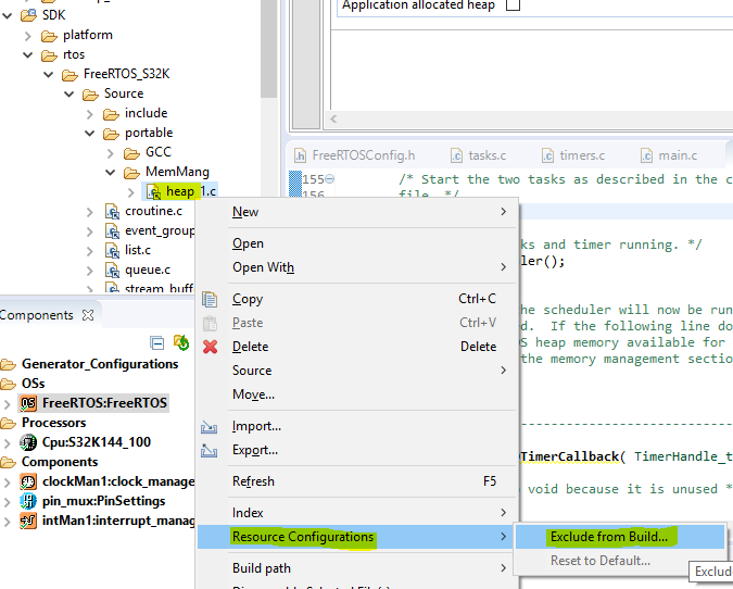

Now, the static allocation will be used and dynamic allocation will be disabled. There is one more step to be done:
2. Exclude "heap_x.c" file from build
The Pex component will still link a heap_x.c file to the project at this point. You will need to exclude it by selecting it, right click -> Resource Configurations -> "Exclude from Build..." and select all options.
After this, the file should appear slightly greyed out and with a different icon, as below:
At this point, the setup is complete.
