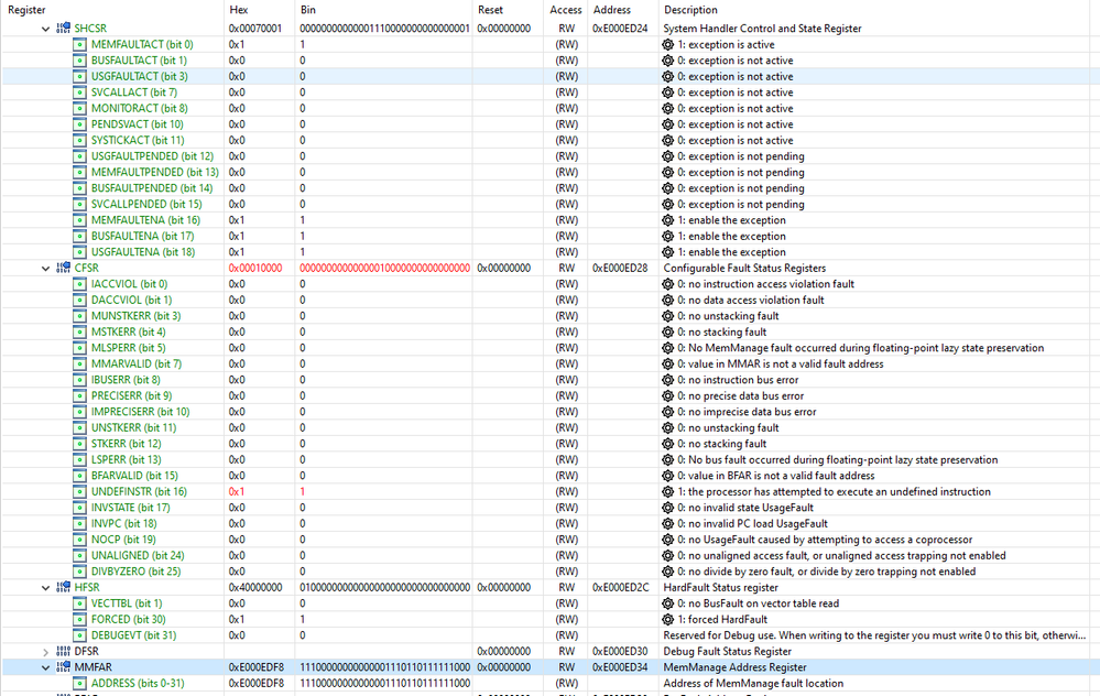

We are a team of 3 developers, and i had a project using your example "flash_partitioning_s32k146" working well. We have a S32K146_100 pins, 16 MHZ clock in our project. Others component already presents were : canCom1:flexcan, intMan1:interrut_manager, watchdog1:wdog and clockMan1:clock_manager which i already talk about.
And my collegue just added somes components, such as: lpit1:lpit, pdb0:pdb, adCinv0:adc, trgmux1:trgmux, flexTimer_Task:ftm_mc and flexTimer_pwm1:ftm_pwm.
Somehow, something is broken now. And it throw a DefaultISR after i try to do
void vInitFlashMemory()
    status_t ret;        /* Store the driver APIs return code */
    /* Install interrupt for Flash Command Complete event */
    INT_SYS_InstallHandler(FTFC_IRQn, CCIF_Handler, (isr_t*) 0);
    INT_SYS_EnableIRQ(FTFC_IRQn);

    /* Always initialize the driver before calling other functions */
    FLASH_DRV_Init(&FlashEEPROM_InitConfig0, &flashSSDConfig);

	 ret = FLASH_DRV_DEFlashPartition(&flashSSDConfig, 0x02u, 0x08u, 0x0u, false, true);
	 /* Re-initialize the driver to update the new EEPROM configuration */
	 ret = FLASH_DRV_Init(&FlashEEPROM_InitConfig0, &flashSSDConfig);
    /* Make FlexRAM available for EEPROM */
    ret = FLASH_DRV_SetFlexRamFunction(&flashSSDConfig, EEE_ENABLE, 0x00u, &EEPROM_status);
It goes inside FLASH_DRV_EraseAllBlock function, then FLASH_DRV_CommandSequence, and at the end of the function throw a <signal handler called>() at 0xfffffff9

Do you have any ideas, about what could have broke the project and give me this issue ? I am searching for a week now, and i am running out of ideas of where to look.
I have read some topics from other projects, which are saying that the Vector table must be in RAM too for some cases, as VTOR, but i don't know how to do that.

I found in SHCSR register a value that indicates me a MemFault
