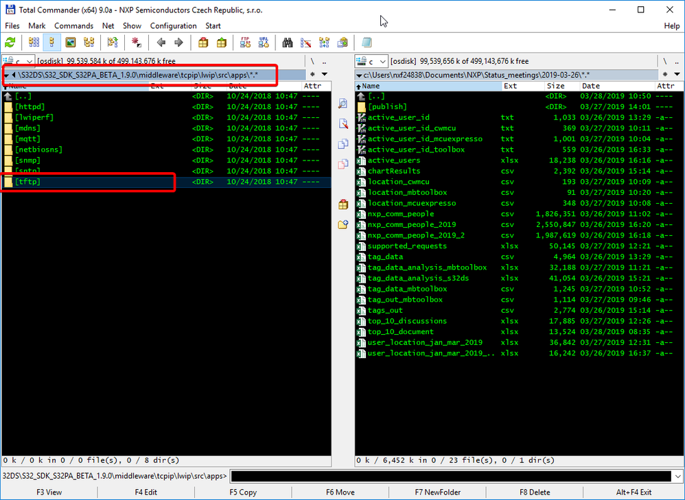

jiri_kral
Hi Vignesh,
actually - it is hard to say what you need to change. LWIP is not NXP product and I'm not familiar with it in deep. But good starting point is LWIP documentation - http://www.nongnu.org/lwip/2_1_x/index.html
If you go through LWIP in S32DS - you can find that there is already tfpt server implemented in apps.
Looking at the source is another good source of information and may be you can reuse it. Anyway - what you are trying to implement? If I'm correct - for TFTP you also need file system on target machine (MPC5777C) - another challenging task.

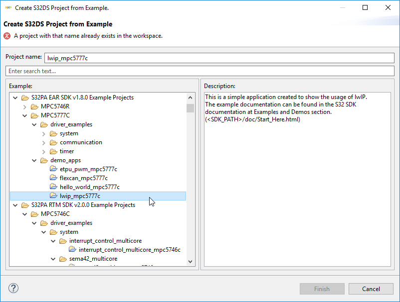

jiri_kral
I see. So - in my opinion - easiest way is start with LWIP SDK example and it's documentation:
This example is without FreeRTOS and it is good starting point for implementing TFTP client. It is possible that there is already done tftp client for LWIP - you may start with this example - https://github.com/labcoder/simple-tftp/blob/master/client.c

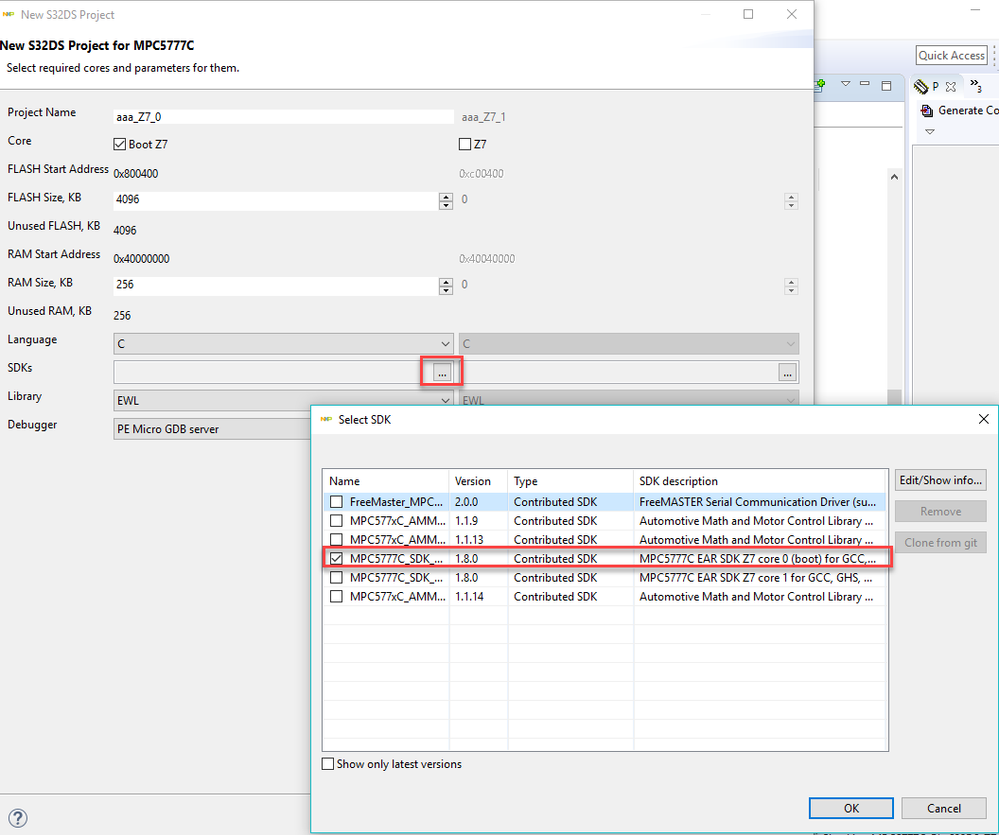

Based on this i have some clarifications . The project i shared the screenshot for trial i did. in actual project ive already done some configurations when there raised a need for adding lwip stack. in that case. Please do not mistake if its trivial i'm new to this.
1. Can i add only lwip stack and make some modifications therein to do tftp implementation.
2.If that is not possible can i resuse the stack that is being used in the example.
    a.In this case if the project is already created can i add SDK in the already created project and do the above steps.
    b.The screenshot says its MPC5748 SDK and is there SDK separately for MPC5777c and can it be added after creating project also .

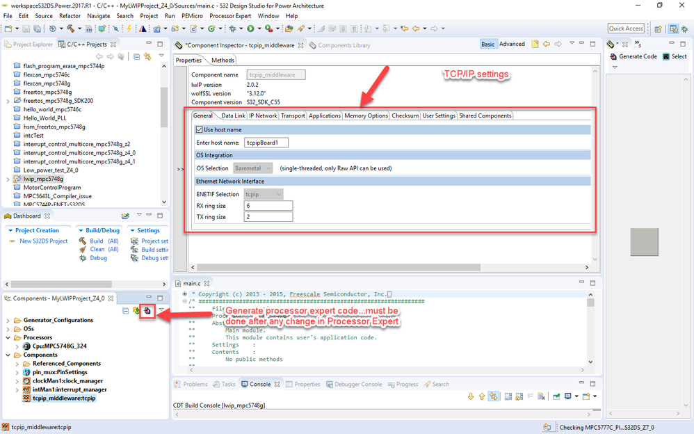

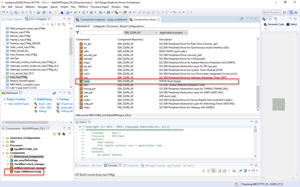

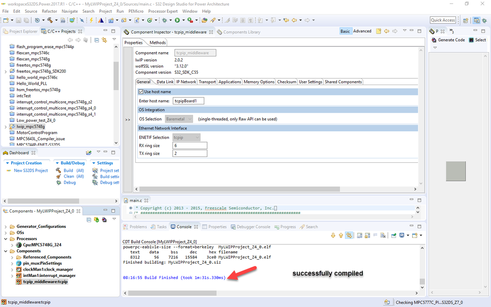

martin_kovar
Hello Vignesh,
according to the figure above, it looks like you did not created SDK based project. If you want to use LWIP stack without FreeRTOS, there are two possible ways, how to do it.
1) Create LWIP project from example and delete FreeRTOS component if you do not need it.
2) Create new project and choose SDK RTM 2.0.0. Then insert LWIP component into this project, create required settings in Processor Expert and generate Processor Expert code. Now you should be able to compile project correct.
Please see the figures below:
Martin
