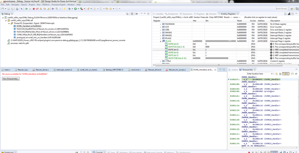

After that, I have tried continues test with debug control sometimes. I have faced that a little time after, all interrupts are generated, rx warnig, rx overflow, rx frame avaliable. And CPU gets IVOR0_handler(), it is not avaliable now.
Here is the screen shot of my project status at that time,
Also your SDK interrupt service routine is not able to reset rx warning and rx overflow interrupt flag.

Hi Eyup,
which SDK version do you use? Generally it is not recommended to modify the driver, we cannot guaranty the functionality then.
For example FLEXCAN_DRV_ConfigRxFifo  in the SDK RTM 1.0.0 is properly filling the ID filter element so no modification is needed.
I created simple demo base on flexcan_mpc5748g example in this SDK version and it runs properly.
You can refer to https://community.nxp.com/docs/DOC-342882
BR, Petr
