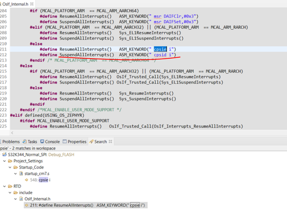

what is the recommended way to disable/enable all interrupts when using the RTD drivers?
Is there any API functions available?
Thanks.

Hi@superbird

Hi@superbird
