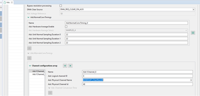

      I am currently using S32 Design Studio version 3.4, and I have imported the S32K3 RTD AUTOSAR 4.4.2.0.0 D2203 example projects. Specifically, I imported the ADC_example_s32k344 project for use with my S32K344 board. While I have successfully tested I2C, SPI, and UART functionalities, I am encountering issues with the ADC_example_s32k344 projects.
Upon importing these projects, I noticed that there was no pin configuration provided. Consequently, I manually configured the pins. However, I am uncertain about how to configure the ADC pins within the Pin config tool.But in ADC module -> Adcconfigset->Adchwunit -> they are selecting BANDGAP_ChanNum48
i cannot able to understand how they are configuring ADC pins
I have attached the screenshot
I need to know how i can check this example code in which adc pin i need to check
please help me out .

Could you please provide documentation on how to read the ADC value for an ADC pin in a microcontroller? The example provided only demonstrates monitoring the reference voltage, and I would like information on how to read ADC values for specific pins in the microcontroller

Check the following links. There is information related to the topic that you might find useful.
AN13413: ADC Guidelines Spec and Configuration
Example S32K344 PIT BTCU ADC DMA

This example uses the bandgap ADC channel (channel 48) to monitor reference voltage. This is an internal reference channel, so no connection is needed.
