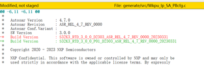

I'm using S32 DS to generate some driver code, and I found many files(generated by other people) that I didn't modify also changed. And the only difference is the build version.
We're using the same DS and SDK, why are the build versions different?

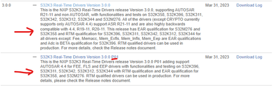

Due to it's only the fixed comment parts in the package, so i think that the package RTD in other's PC is not the same. We have the RTD 3.0.0 release and RTD 3.0.0 P01.
Could you please help me to check the version of RTD package installed in the PC?
