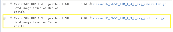

hello,
   When I execute the program: apex_downsample_upsample_cv, the program outputs:
Cannot find input image data/common/in_gray_256x256.png.
   Other routines that need to open the image are the same result.
   The BSP version I am using is VisionSDK_S32V2_RTM_1_3_0_img_yocto
 The version of visionSDK I am using is  VisionSDK_S32V2_RTM_1_3_0_HF1
 The board model I am using is SBC-S32V234.
SBC-S32V234
