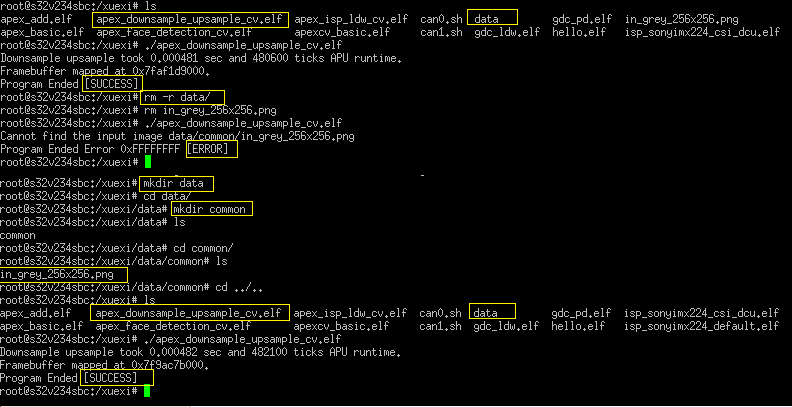

   When I execute the program: apex_downsample_upsample_cv, the program outputs:
Cannot find input image data/common/in_gray_256x256.png.
   Other routines that need to open the image are the same result.

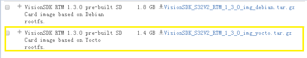

   The BSP version I am using is VisionSDK_S32V2_RTM_1_3_0_img_yocto

hello,

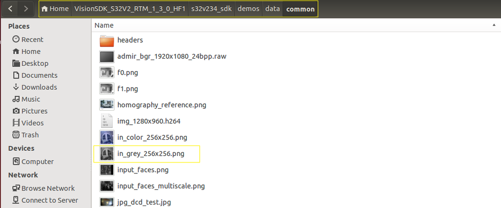

  The data folder path is as follows:
The path in the source code is represented as data/common/in_grey_256x256.png,as shown below:
I copied the data/common/in_grey_256x256.png  to the development board, and the same path as the apex_downsample_upsample_cv.elf file.Program execution succeeded.
The test process is as follows:
Thank you very much!!!

jiri_kral
did you copy data folder (by default located in VSDK folder - c:\NXP\VisionSDK_S32V2_RTM_1_3_0\s32v234_sdk\demos\data ) next to your example executable?
