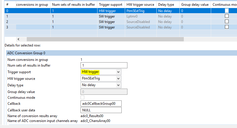

Is it possible to change between HW Triggering and SW Triggering for a single Group?
Because I have to measure a signal which is either constant at a specific voltage, or a PWM.
So I want to change the triggering for a ADC_PAL Group depending on the signal (PWM or static). The PWM Signal is generated by the FTM5. Thats why I set FTM5 as HW trigger for the conversion in Processer expert.

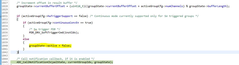

So I disabled the HW Triggering first to measure the stable signal (SW Triggering). This worked once, but for a second measurement, the function ADC_StartGroupConversion() returned STATUS_BUSY.
It seems that the "active" status will not be reseted after a conversion (in ADC_S32K1xx_IrqHandler()):
This because the variable activeGroupCfg->hwTriggerSupport is set to true.
For the next steps I would like to Enable HW Triggering and measure the PWM signal on each period. But when the repeated measurement by SW Triggering of the stable signal does not work, I can't proceed.

Unfortunately the ADC_PAL does not support updating triggering (SW <-> HW) for a group, without Deinit().
Instead, to achieve your scenario, you would need to create another SW triggered group, configured to measure the same channel which you are measuring via HW triggered group.
Also please note that ADC_StartGroupConversion only supports calling groups configured as SW triggered

-It is not possible to have two HW Triggered groups active at the same time for one ADC. But is it possible to have a HW Triggered Group active and some SW Triggered groups for the same ADC instance (See first picture in the original question)?
This seems not working for me, but I'm not sure if I made a mistake or it is even not possible...

Enabling another HW triggered group while other SW triggered is running will return BUSY.
Also, I would like to mention that there is an example in S32DS adc_pal_s32k148 which uses ADC PAL for a series of SW and HW triggered groups of conversions.
