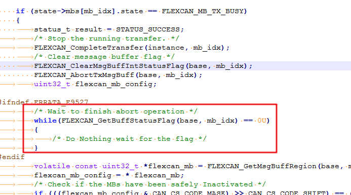

    When we use FLEXCAN_DRV_AbortTransfer to abort the CAN message transmission, our routine is stuck in the while loop.
   The description of abort process in RM is showed below:
   It means an interrupt is generated when ABORT code is write to register.
   Does it means that a interrupt is generated after calling  FLEXCAN_AbortTxMsgBuff? If so, the interrupt routine will be processed, and the IFlag will be cleared in the interrupt, the code will stuck in the while loop.

The driver function "FLEXCAN_DRV_AbortTransfer" is doing FLEXCAN_CompleteTransfer should disable the interrupt before issue the abort operation code. Can you check if is doing ok the disable of the interrupt ? Maybe something else is reactivating it. Can you check if before execution of "FLEXCAN_AbortTxMsgBuff" if the IMASK register corresponding bit for mb_idx selected for abort is cleared ?!

cheney
Hi, Alexandru:
Thank you for your reminding, It's exactly the mailbox interrupt is not disabled in FLEXCAN_CompleteTransfer.
Normally the can interrupt is disabled when a CAN message is received. And the new CAN message can not be received anymore unless you recall FLEXCAN_DRV_Receive.
So we think it is a good idea to remove the FLEXCAN_SetMsgBuffIntCmd(base, mb_idx, false) from FLEXCAN_CompleteTransfer. This operation effect the CAN message cancellation.

Can you specify on which platform ? and What are the code changes ?! Do you execute in multiple thread Mode ?
3,589 Views
cheney
Hi,  alexandrunan :
Thank you for your response.
It is occurred in S32K144, the code is not executed in multiple thread mode.
First, i disconnect the CAN line to CANoe, and i send a CAN message. Then i use the api FLEXCAN_DRV_AbortTransfer to cancel the message i sent. When the function is executed, it will stuck in the line i showed before.
If i disable the global interrupt or CAN interrupt when i call the function "FLEXCAN_DRV_AbortTransfer", it works fine.
So i want to confirm if the interrupt need be disable when the function FLEXCAN_DRV_AbortTransfer is called.
