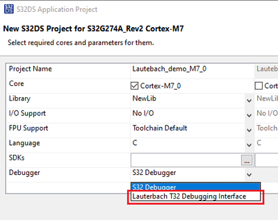

Hello team,
I'd like to use Lauterbach debugger to program S32G in S32DS v3.4.
the required plug-in for Lauterbach is installed from lauterbach website.
but there are some files missing for S32G debugging.
see attached image.
Please suggest.
Thank you.
6,016 Views
mikedoidge

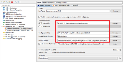

Hello @Rick_Li,
If you create a new application project using the wizard, you can select Lauterbach as debugger.
Then go to the Debug Configurations menu and you'll find these fields already completed for you. This is done as part of the New Project Wizard. However, when you create a new launch configuration for Lauterbach from within the Debug Configurations, it won't add these details. So you can copy them from the dummy project to the new launch config for the existing project, since they are not project-specific.
Hope it helps!
