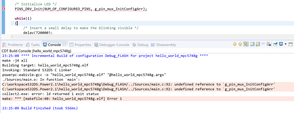

undefined reference to `g_pin_mux_InitConfigArr'
3,006 Views
feng_ang
undefined reference to `g_pin_mux_InitConfigArr'屏幕截图 2023-02-24 233136.png屏幕截图 2023-02-24 233136.png
I made an error when compiling this file. I still made an error after updating the patch of version 14

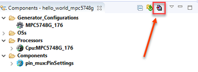

Hi @feng_ang
did you generate the code before compilation?
Or select in main menu Project -> Generate Processor Expert Code.
This is usually the source of similar errors.

2,973 Views
feng_ang
Thank you. I have solved this problem.
