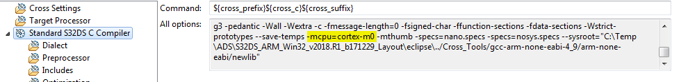

I am using S32 Design Studio for ARM Version: 2018.R1 Build id: 180815.
I need to to do some setiings in
Project Settings ->C/C++ Build ->Settings->Target Processor
I want to change toolchain default to some project specific settings.
After clean and then build the .args files do not contain the new settings.
Eg when I specify "cortex-m4" I expect the option "-mcpu=cortex-m4"
in the .args files.
What do I missed to do additionally that the options are correctls included?

Hello Edgar,
yes, you can manually fix the project files. you can open .cproject file from imported project in any editor (make sure that project is closed in IDE) and you need to find statement like this  <option id="com.nxp.s32ds.cle.arm.mbs.arm32.bare.option.target.mcpu.cortex-m0plus842350448" (the number could be different). The value should be corrected to remove "cortex-m0plus" (or "cortex-m4" correspondingly), so it will look like: <option id="com.nxp.s32ds.cle.arm.mbs.arm32.bare.option.target.mcpu.842350448"
after that you can reopen project and setting should start work normally.

b13310
hello Edgar,
just to make sure - are you changing settings for the same build configuration where you check args file?
In general you can check what options would be generated on settings page for Compiler

jiri_kral
I did some research  - and it looks that for example projects based on SDK can't be this settings changed (it is overwritten by example internal settings). When you create new project from scratch or use non SDK example - you can change this settings.
Thanks for report. I'll create bug ticket.
